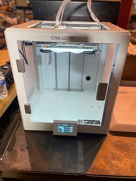

Santa delivered this to me a week late ... Kind of like my own Star Trek replicator
I'm sure at some point I'll make something practical with it, but for now I'm doing test prints of a manifold lid at 1/2 scale. It can print ABS material which means I could actually print a functional manifold in the future ... for testing purposes.... who knows
(print table can handle 14.9" x 11.8" x 8.8" )

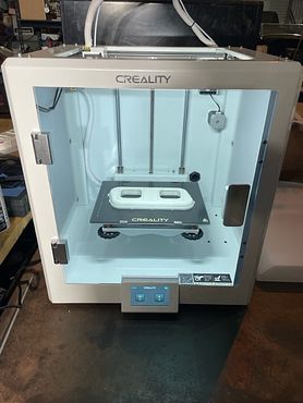

Testing 1, 2, 3 ...

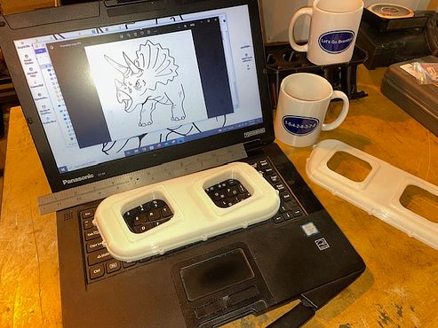

at 1/2 scale it's about 9.5" long and 4" wide
The stock settings take this top 11 hrs to print. After changing some settings the print time was reduced to 8 hrs. Made another change and it can now print in 6 hrs and looks great. It will take 26 hours to print the manifold base at 1/2 scale. I'll print the base when my batch of filament shows up.

BTW, like your cool coffee cup holder!:cool:
a friend printed that for me a year and half back at 3/8th scale. I'll print it at 1/2 scale this weekend if not before. I'll check the print quality of ABS vs PETG filament
With the ABS filament I'll be able to print this full scale in a couple/few parts and then epoxy it together. ... We'll see how that works out ;)

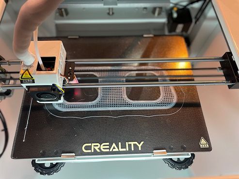

So when I walked into the shop Saturday morning I see this - The last I had my eyes on it, at 55% completed at 10:30 pm Friday night it was looking great. Somewhere around 85-90% completed something went haywire ... IN A BIG WAY:
After cleaning up that mess with the first print with PETG filament I decided to switch to the ABS since that's what I actually purchased this machine to print.
Next test with ABS It was printing fine and at 33% I decided to take a look before I was going to walk away for an hour or two and I see this:
Son of a bitch:
Had I walked away a few minutes early that would have turned into a hell of a mess.
After reading some tips on the internet I made some adjustments and started over ..

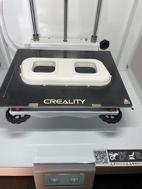

Walked in the shop this morning and was greeted with this:
Now that I have a perfectly printed top .... I need something to bolt it to .........
Should be completed early tomorrow evening ...
