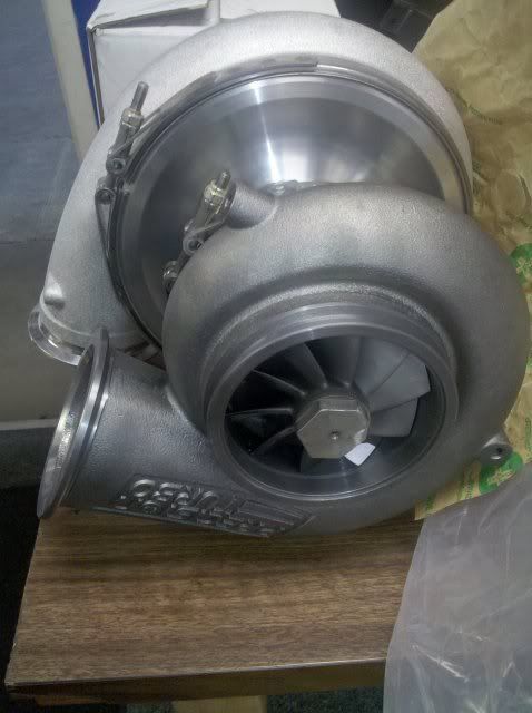

TiAL units are nice but the ones I have seen do not have mounting bosses cast into the units. Precision units do.
Sorry for the picture size.

Having a round entry would help by not changing from round to rectangle back to round. Staying round from the collector to the wheel would help and having no change in diameter until it is reduced as exhaust is fed to the wheel would be beneficial. If the transition changes the volume then energy is used. It would be nice to see how much better they actually are.
