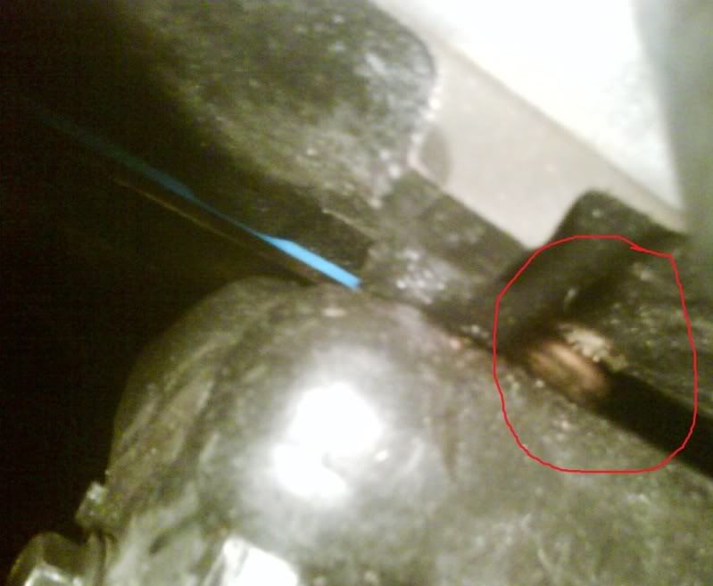

Well my Garage is Colder than I thought... Went to Start the Engine, to warm it up to move some oil around, and when I started it, I heard a Belt Squealing... Hmmmm
I looked at the Pulleys while it was turning over, and the Water pump Pulley was not moving... Frozen... then I thought "Faaack" Freeze Plugs... and Sure enough, the one on the Front of the Drivers Side was pushed out...

You better do more checking. I have seen many blocks that cracked, and pushed out large chunks of the lifter valley after they froze.

About ten years ago i found a freeze plug on the ground near my chevelle, i also found that the block split in the lifter valley. Not some junk 2 bolt mainer but, a bowtie block. I hope your luck is better than mine.

"why" would you not use antifreeze in your car in the winter when your not racing ? if you pushed the core plugs out id be willing to bet that block is cracked too.
