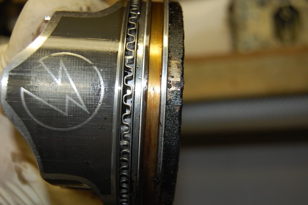

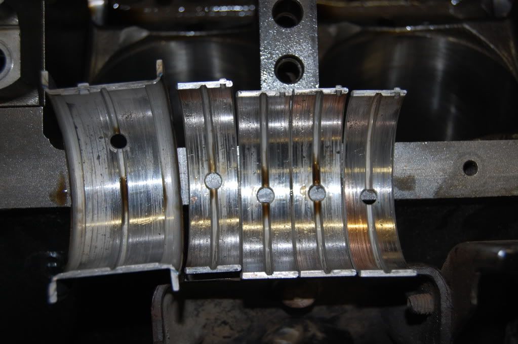

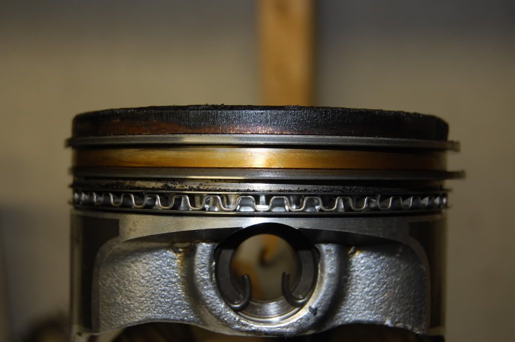

Trying to figure out what caused this. SBC wiped out the bearings. Looks as if it started with the #3 main, and worked towards either end. It doesn't look to me like it was an oiling problem, because nothing really got hot except the #3 lower main. I done everything I know to do, and have always done when I put this thing together. I would just like to come up with an explanation before I start putting it back together. This is a mild 383 street engine that doesn't see over 5000 rpm. Was a brand new eagle rotating assembly. This thing also had a very serious blow-by issue that I can't seem to find the cause of either. Engine only had about 5000 miles on it, and it used about a quart of oil every 1000 miles. Is fuel injected with vortec heads. Had pcv as well. Pay attention to the second ring....I'm told that it is supposed to be a tapered ring, but just a fraction of the ring touches the cylinder wall. I was suspecting that this was the cause of the blow-by, but like I said, I was told otherwise.
12,147 Posts
I assume the oil looked like metal flake paint. If you don't think it was an oiling problem, then the oil must have been contaminated enough to scuff everything up?

That is the way the rings are supposed to look. That is NOT how the bearings are supposed to look. Bearing clearance? Dirt? pickup tube?

Pickup tube is clean with no debris, bearing clearance was about .002 rod and main according to plasti gauge. Was using 10w30 motor oil.
So, if that is indeed how these rings are supposed to look, I wonder if maybe the machine shop put the wrong finish on the cylinder walls, causing the blow by.

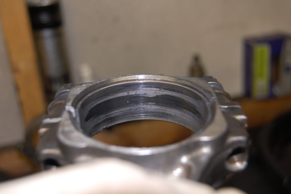

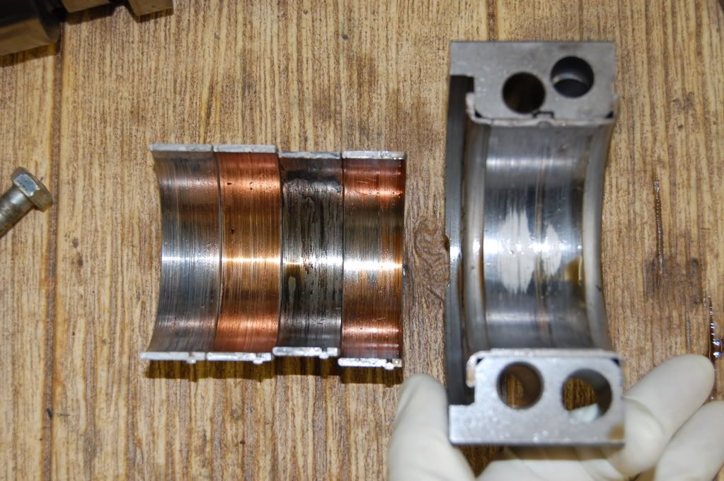

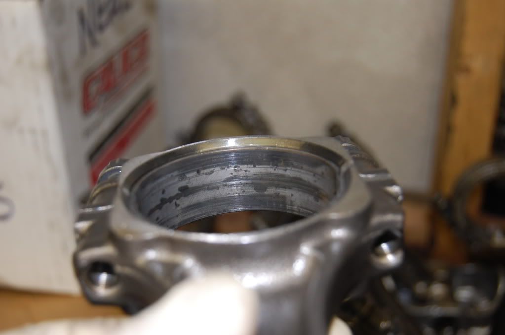

Now, I believe the rod bearings were damaged due to debris (bearing material) coming off the main bearings. If for some reason debris ran through the mains, wiping them out, why would it destroy #3, and progressively get better as it moved toward the outsides of the block? Also, why would it only destroy the cap side of the bearings, and not the block side?

If you say it started at number 3, I would guess if you check the alignment of your mains, your going to find a problem. First number 3 starts going, shoving metal into the oil and it is pretty much a downward spiral from there. Get it align honed.

It looks like alot of debris went right to your bearings from not having the oil filter bypass plugged and not using a good filter and the machine shop that did your work may not have cleaned the oil galleys properly.
By the looks of the blowby the piston shows blow by right down to the oil ring which is probably caused by not using a torque plate when the block was finished honed. A leak down test at TDC would confirmed your ring seal issue.

I noticed also that the main caps show no signs of a line hone which I feel is a must when building a performance engines.

We also found on the main bearings that there was copper showing near the sides of the pating lines as the block was never line honed during the rebuild.

X2 Dirt&debrie It`s all embedded into the rod bearings, it looks like the crank wasn`t cleaned prior to start up..an area many forget to clean is the crank journals, rifle brush every passage in the crank and block before assembling. I`d ask for my money back on that bore job too, Pistons and lands look like my BBQ pit

The block is in the machine shop getting align bored as we speak. That was one of my suspicions after pulling it apart, but when I originally assembled it, the crankshaft spun free in the block, with no resistance, so it really didn't strike me as needing an align bore. The block was also honed with torque plates as well.

With the amount of blowby the pistons are showing I would question the plate hone.
