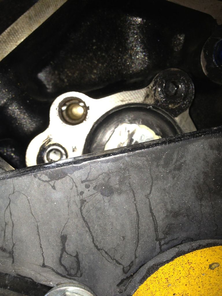

My buddy just sent me this pic and what's to know if the oil galley plug inside needs to have a plug in it . He said the one on the right is blocked by the Distributor.

If it is the same as the iron eagle the inner plug is either solid or whatever size restrictor u use then also needs the plug on the outside to keep the oil in look on darts website under directions for iron eagle oiling they have a good pic and description

thanks for your help hes been running it without them :rolleyes: must be a lucky basterd lol

lol no problem thanks for looking out ;) . I told him he better call dart in the morning . I feed my motor from the front and have restrictors in the back but I Think he needs to block them off if hes feeding it from the back .

You're looking at the oil galley to the right and left lifter bank. All it amounts to when you run without those inner plugs is running without restriction to the lifters. The distributor has a groove that should line up with the oil passage to let the oil around. To restrict the lifters, drill your desired orifice size into a 1/4" NPT plug and install.
The oil comes in the block from the filter and goes to the oil galleys at the back of the block. The lower left galley is the main oil galley, with the other two lifter galleys. From this point oil travels toward the front of the block. On my block, I have the inner plugs of the lifter galley at the rear blocked off, which forces all oil through the main galley first. Once the oil reaches the front, it is circulated back through the lifter oil galleys toward the rear. I have the inner plugs on the front drilled to .100 for a slight lifter oil restriction in my block.

cool thats what i been looking for thats the opposite of my motor but I feed it from the front. so can he block the back ones off and leave out the front ones? or is it better to put plugs in with a .100 hole?
