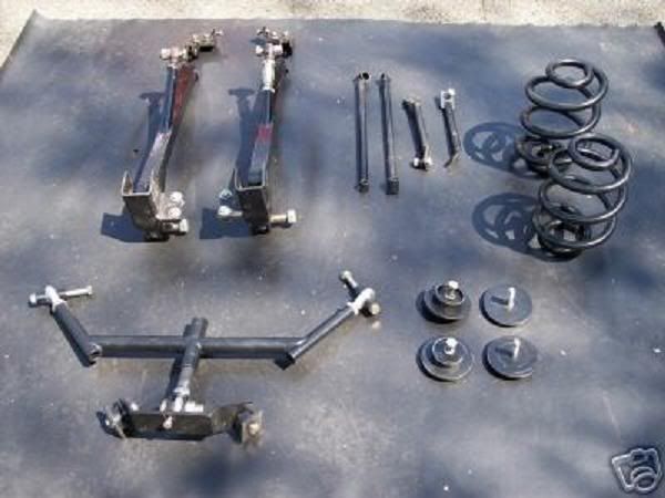

Here is Dumb Ass Foot Breakers Idea of "Stock Susp." its a Fucking bolt on ladder bar
Big Wheel Stands are not a problem with 3 feet of front tire drop
Who makes that?!
Who makes that?!
Alf Weibe is his name,he races locally at Mission Raceway up here in Canada ,he is a stock eliminator suspension guru.........Unless you run a stock class,he won't give you the time of the day.
