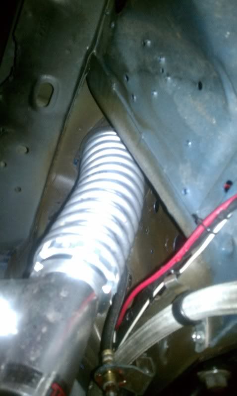

Should this
Cause this?

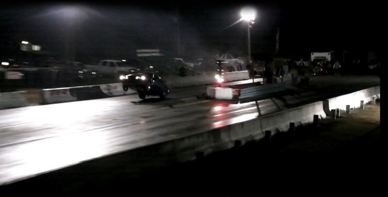

The car didnt come down too hard I have seen worse it only touched the headers. The struts are QA1's new d/a's with less than 30 passes. and this was there first big wheelie (first night out on hoosier 275's :supz: ) Oh yeah both sides bent like this and blew fluid all over the place

I have seen some hit harder and not hurt anything (Sans headers) and I seen some that didn't hit to hard and bust the shocks and flatten out a wheel or 2,
I think its the luck of the draw and how they are set...

Do you think the suspension is bottoming out on the struts? That's a lot of force.
I dont think it can. We only have about 2-1/2 to 3" clearance between the ground and the headers and it didnt bash the headers that bad. the headers hit before the strut botoms out.

I don't know what caused it but that has to be caused by something other than horizontal force. Cuz it's normal all year long ever year with my QA1's. And I weigh 3550 lbs.
