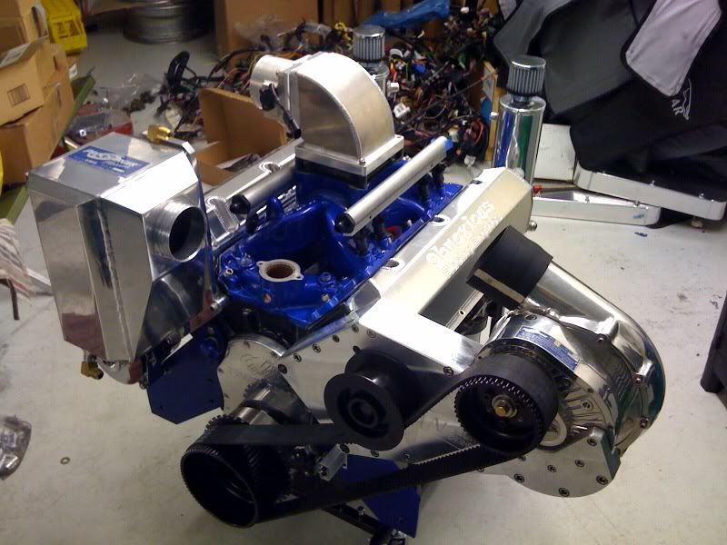

here is a pic, so you can understand what i'm talking about with the bracket and blower location.
Who makes that intercooler? I am guessing that is what it is.
the intercooler is made by procharger. it is the largest "Marine" intercooler they make, it is a water to air intercooler and ridiculously expensive if you buy it new....polished version somewhere around 1800 or so....i got it as a package deal from a guy. however it is a very nice piece.
