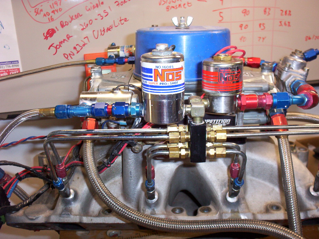

I previously ran the engine on one fuel system and the nitrous on another (it's own pump). Both systems are deadhead (no return) with no air bleeds either. To minimize creep, I always turned the nitrous fuel pump on right before I prestaged.
Now, I've combined them into one system (-10 line) off one pump (BG400) and I have a fuel log at the front with the engine regulator and the nitrous regulator. Both are still deadheaded.
I have no issues with the engine side, but I had not thought about the fact that I now have fuel pressure on the fuel solenoids and no where for it to go. I went for a short drive the other day and even though I have the nitrous FP regulator set around 7 psi, I was getting over 10 psi and climbing during the short drive.
I'm guessing pressure will drop quickly when I spray it and the solenoids open, but I'm worried about that much fuel on the hit plus much much is too much on teh solenoids? I don't want them to leak or anything when running N/A or on teh motor.
Running 20 psi at the fuel pump (it has a bypass built in).
Do I need to run bleeds before the fuel 'noids or do I need a bypass regulator or ???

Also, looking back at your picture and how far the regulator is turned in, it looks like it should be set at about 8-9 PSI ?? If it's set at 5-7 and has to be turned down that far I would replace it now. The springs do get weak over time and hurt it's ability to react.. SJ
...failure to communicate
4,872 Posts
Discussion Starter · #20 ·
Thanks everyone.
Steve, not sure which picture you are looking at, but it's likely not set. After my fuel pump got fixed, the BG regulator decided to die on me. I also had a dead gauge. I plugged the BG regulator (carb) and the nitrous fuel lines and used the Holley for the carb temporarily to get it running.
That's when I found the gauge was flaky as well. that's probably why the setting was off. Not sure when i took the pic. replaced the BG with an aeromotive and capped the Holley for some motor pulls. Going out tomorrow night and if the motor passes are clean, I'm going to hook the nitrous fuel back up and set the flowing pressure and spray it.
