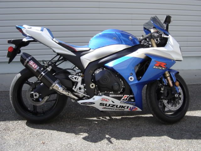

Well i broke down and put on a slip-on. It was incredible. the weight savings and the way the bike responds is unreal. I also did the pair valve mod to get rid of the backfire popping all good. I have to weigh everything, but i think it will be close to a 20 lb reduction.

Well all i know is that the bike bike would pop and backfire on decceleration after the slipon install.Its a pretty common problem with after market exhaust. There is a valve that sucks air or something like that in the airbox. I plugged the hole and it all stopped. All has to do with emissions.

I've done that mod on a few bikes. They usually have a passage in the head from the exhaust port to a reed valve going to the air box that allows air to drawn in to the exhaust for the purpose of combusting any unburnt fuel.
