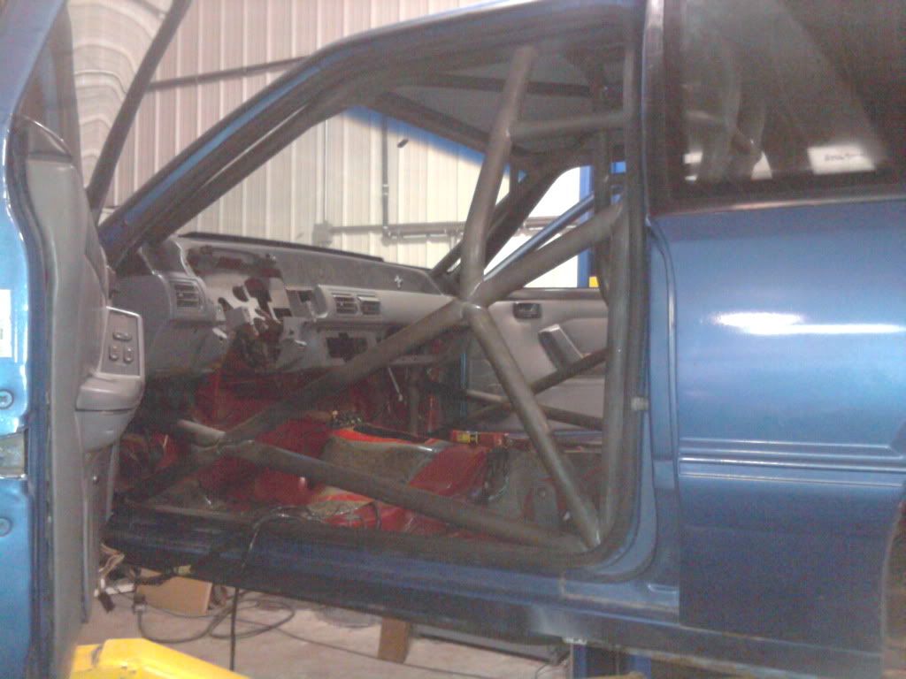

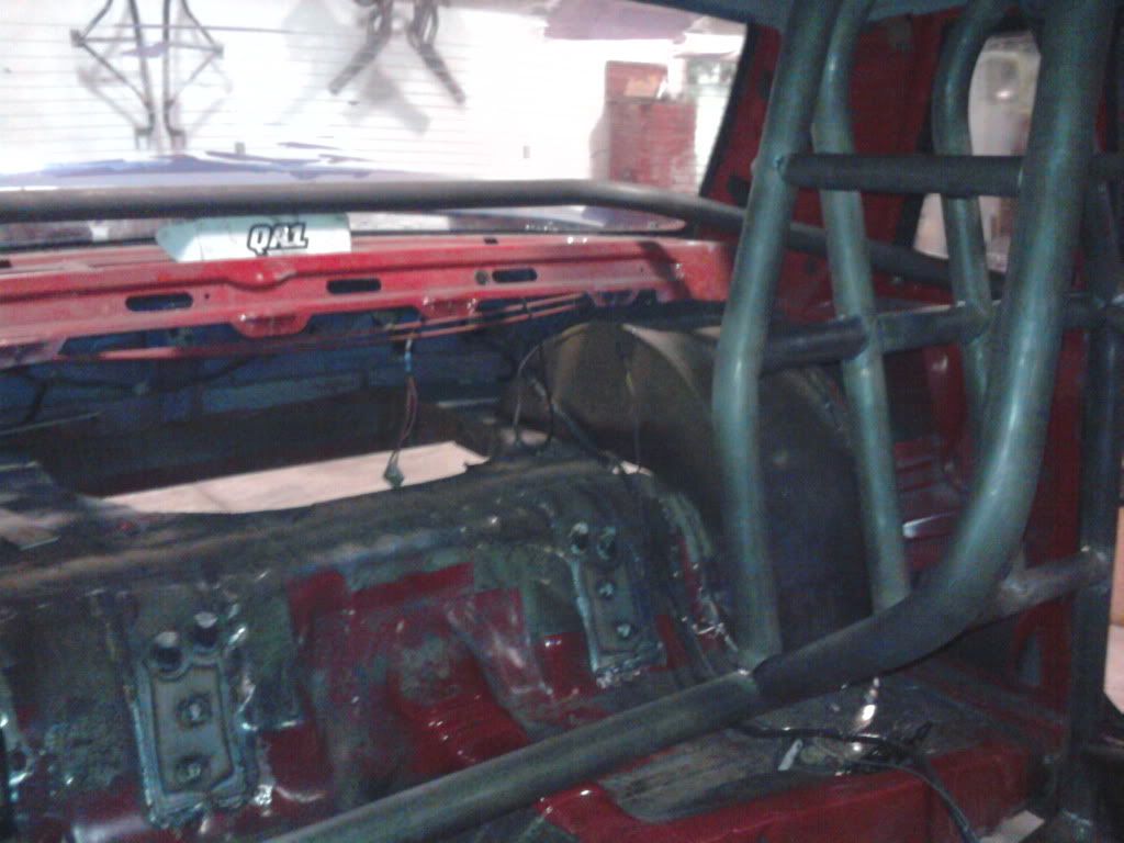

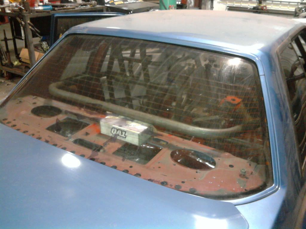

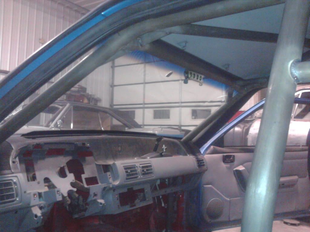

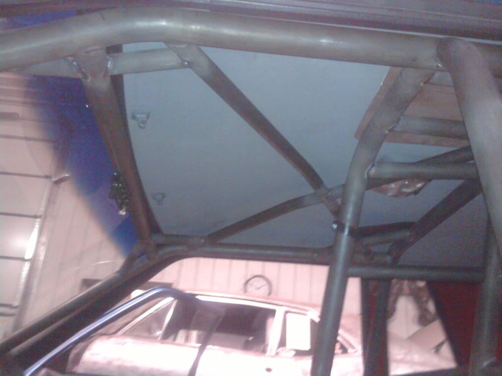

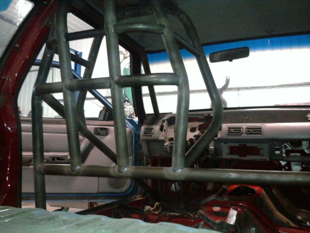

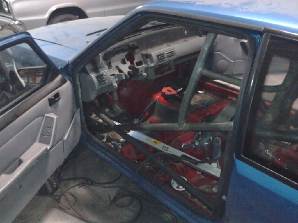

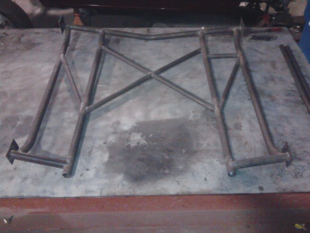

Looks good how much time do you have invested in the build and got any pics of the bottom side like the 6c/crossmember bar:confused:
18,104 Posts
Have you talked to tech ? Just wandering about roof X , book says they intersect bar #13 within 3 inches of the end , like yours I ran to #12a and #12b within 3 inches of #13 kinda wondering if it will be Ok like that . I am thinking I will have to change , my interpetation may be wrong , hoping not .
