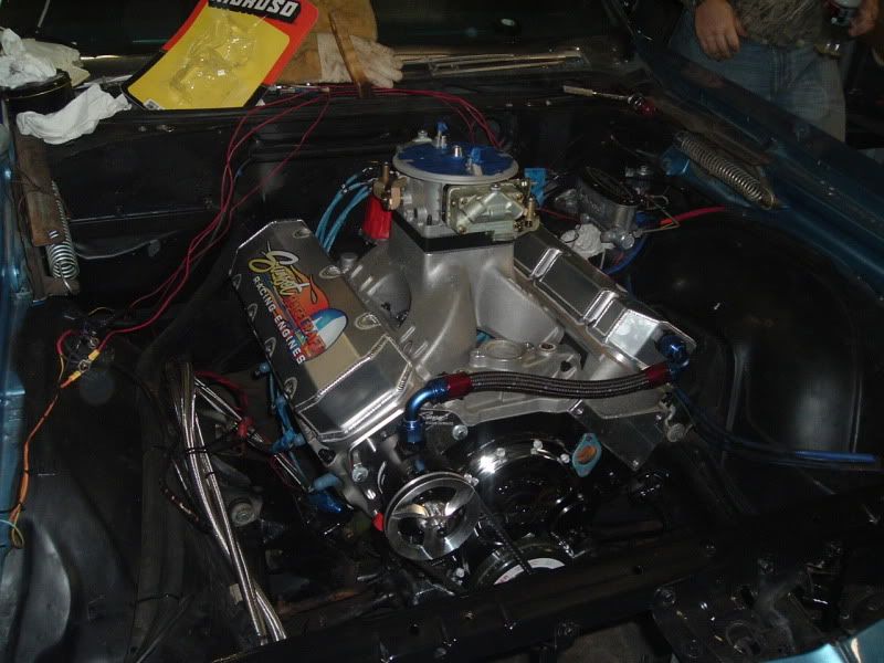

I have started this thred because this is not a easy task . I decided to test fit the engine in the car and got to work on the cross member . Had I not cut the cross member it would have been a B###h to get the engine in . So I hacked away and boxed the frame were I cut and welded in a new crossmember . after all of that work got a friend over and we stabbed the engine in . I went with the solid MOROSO engine mounts Part #62515 which were a little taller than the big block mounts . After all the work here are the pics of how it looked

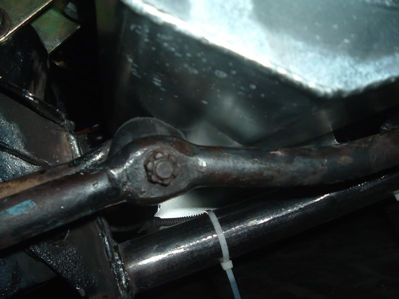

The prob that I am having is the tierod end his hitting the bottom of the pan when you turn to the left anyone have a fix for this prob besides a rack system ?

It may have fit with the stock front cross member but it would have been so tight that it would not be worth trying . with the tall engine mounts it was hard getting the engine back into position I had to take the driver side engine mount off then lower the engine into place then put the engine mount on .
If you turn the steering wheel to the right the tierod will not make contact even with the grease fitting in the tierod . now when left the tierod end makes contat with the pan without the grease fitting you can turn it a good ways before it hits but it will not turn all the way .

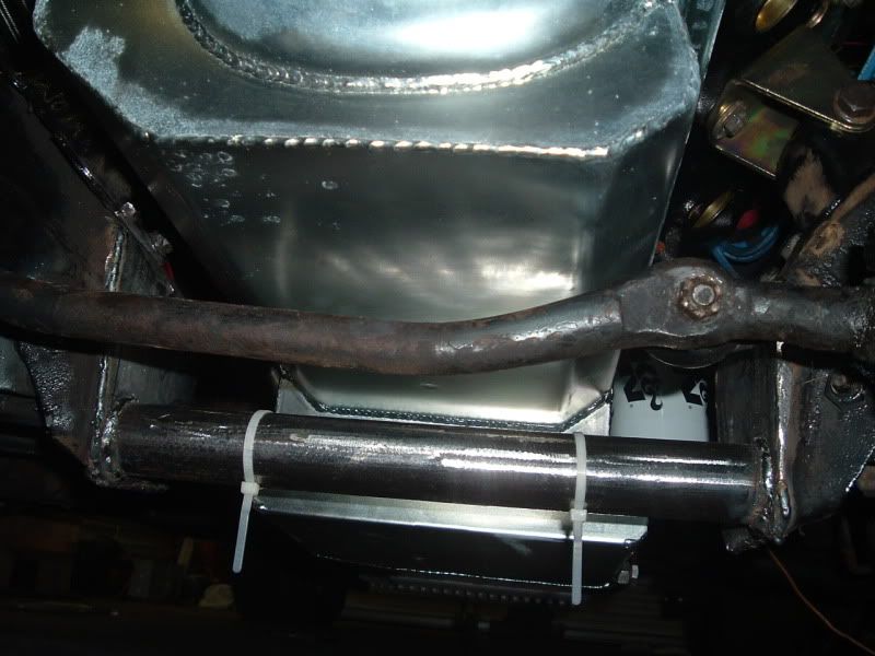

I had a chance to play with the car a little more and I think I may have figured it out . The center link needed to be lower but not much so I have been thinking of what I could do and came up with moving the idle arm My thinking was that if the idle arm was a little lower in the car then it would clear . So I started to unbolt the idle arm and took the lower bolt out and as i pulled on the center section to get under the car the center link dropped and the bottom of the idle arm slid forward towards the front of the car I then noticed that the drag link was free and clear of the pan I then got the top bolt of the idle arm tight so it would not move and worked the steering back and forth from lock to lock no binding no touching of the pan at any location . I then drilled a new hole in the frame and put the lower bolt back in the lower hole of the idle arm and in the new hole and bingo fixed . the steering works fine and will go lock to lock and will not touch anything there is even room for the grease fittings . any thoughts
