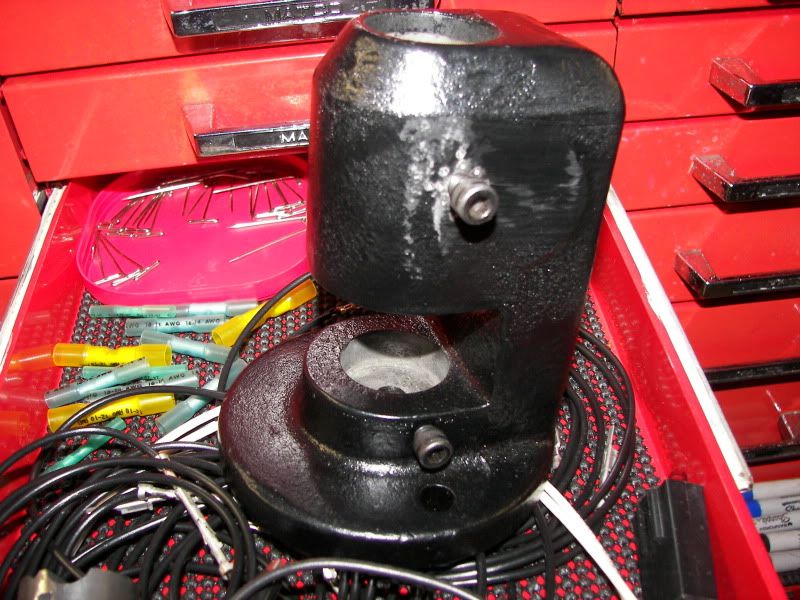

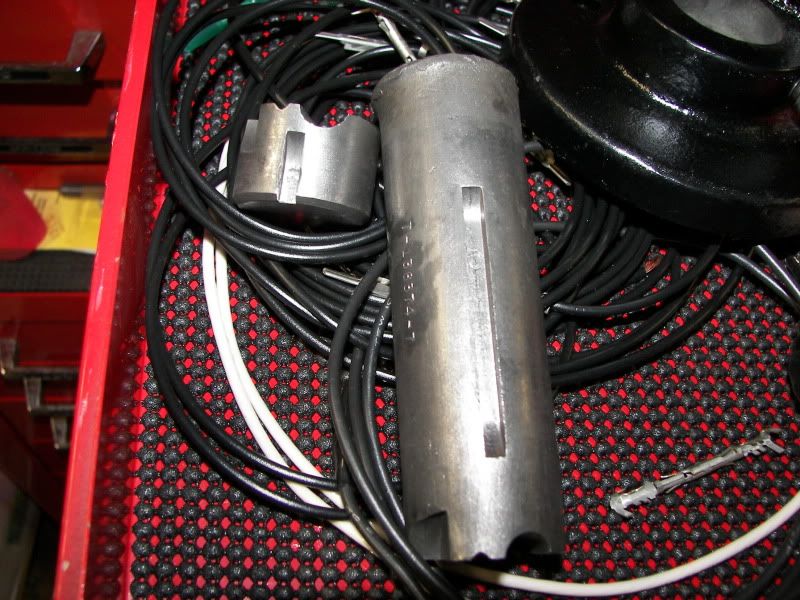

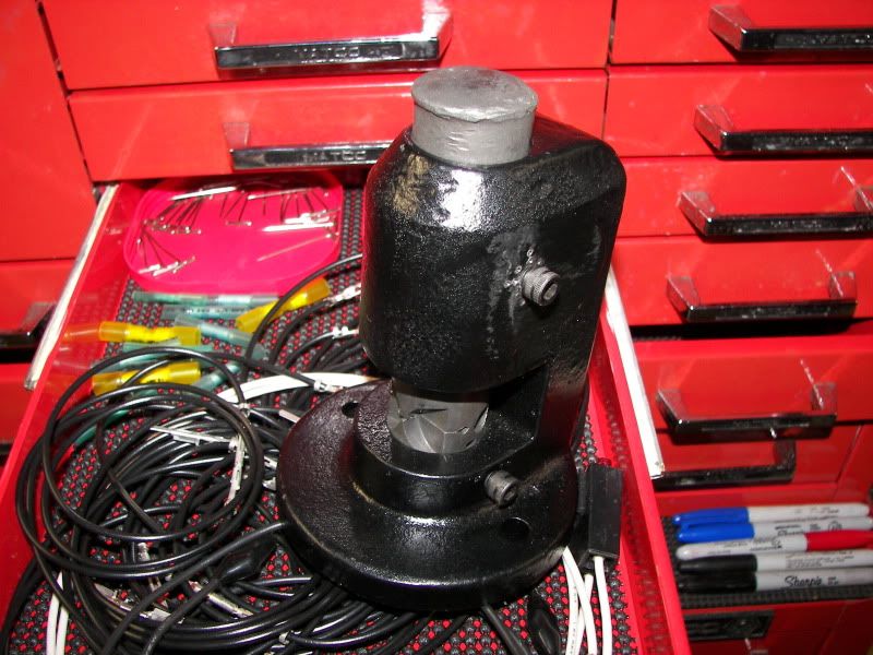

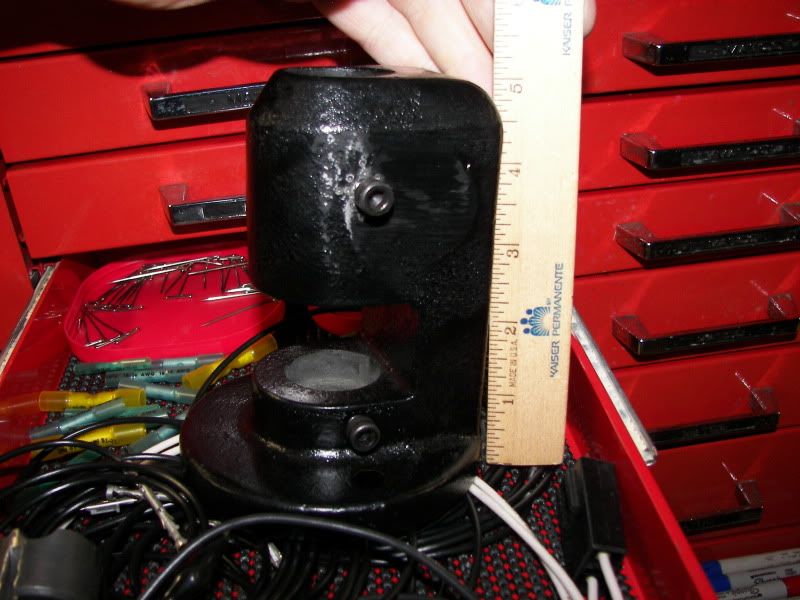

I picked up this crimper, it's for speedometer cables and I'm wanting to make a new set of inserts to crimp battery cables. I plan to use this in a press but maybe with a hammer if need be. Does anyone know what these ends should look like that make the actual crimp? I've got a few different ideas but not really sure if there is a "correct" way or not. If anyone has any pictures of one that would be great

Nothing close up. Once the crimpers are clsoed on the bigger sizes, they form a square.

That looks a lot like the crimper I bought from McMaster-Carr. I'll try to post a few pics later if I can dig my way out to the garage. Mine has wedge-shaped pieces that form the crimp.

thanks, that pic would be great. I picked this up at a swap meet and was told it's pretty old maybe 40's 50's. It weighs close to 10 pounds and says Hennig Tool on the one piece. I just have to find a piece of bar to make up the 2 inserts and I should be set after I figure out how I want to make the crimp.

Techinally you need a different crimp for each size of cable end you use. i.e. 1/0 is different than 2/0, 1ga, etc

Yes I kind of figured that. For now all I'm going to need is one for 1/0 and one for 4 ga I've been dragging my feet on getting my battery moved and everything situated. I did a little more searching and found quite a few that are hexagon shaped so have a few options.
Anyone else have any ideas or some dies they could measure :confused:

As a last resort I would make a universal type one like those but would really prefer a few dies for the sizes. I never really liked the crimps those other ones do. I just have to get my hands on some dies to measure but no luck yet.
