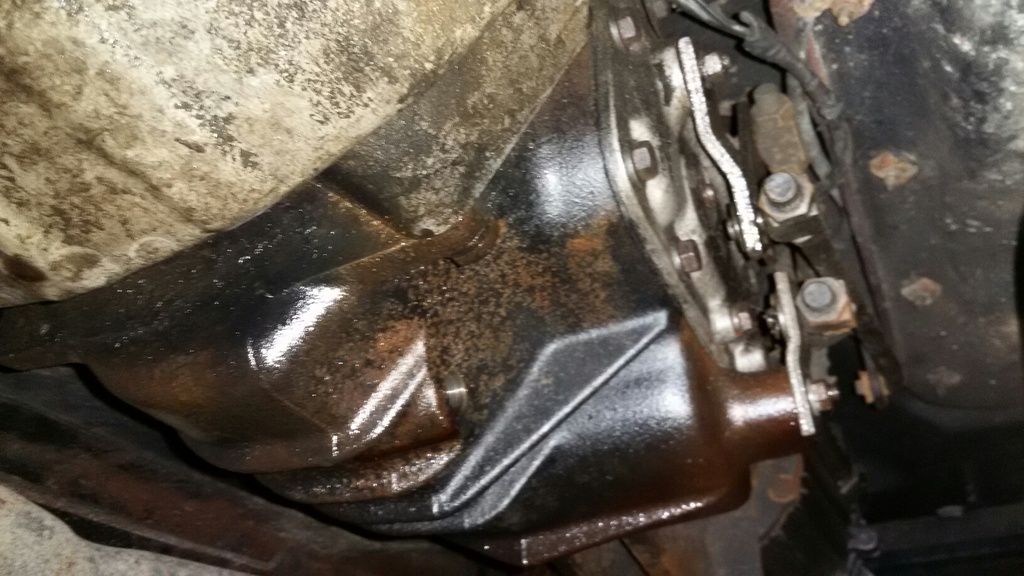

Its in a '85 Chevy K10 with the crappy 6.2 diesel, its a 3 speed with overdrive with a really high first gear, and shift arms on the side instead of a top shifter, has NP208 transfer case behind it, can't find anything on AllData that looks like it.
4,593 Posts
It looks to be the original stuff and its a 3 speed with OD, I've never seen one like it. They ran it dry and burnt it up and trying to either find another one or see if I can swap a 465 in its place, but have to figure out what the hell it is first.

4-speed stick w/ OD A833 MOPAR tranny that they used to put in Chevy P/U's at one time.
Should have something like a 3.07 1st gear, then a really wide 2nd gear like a 700 auto has, an OD 3rd gear and direct 4th gear.
And I think the OD 3rd gear is really weak.
They are around and are pretty good trannies if you want to hut up a replacement. Shouldn't be priced all that high??

PS., you can readily tell them because the 3rd gear lever is upside down to allow making it a OD.

Not sure if you can get the trans code by the serial #, may be to old-some JY's go off the codes

"Should have something like a 3.07 1st gear, then a really wide 2nd gear like a 700 auto has, a direct 4th gear taking the place of 3rd gear, and 3rd gear becoming an OD 4th gear.."
