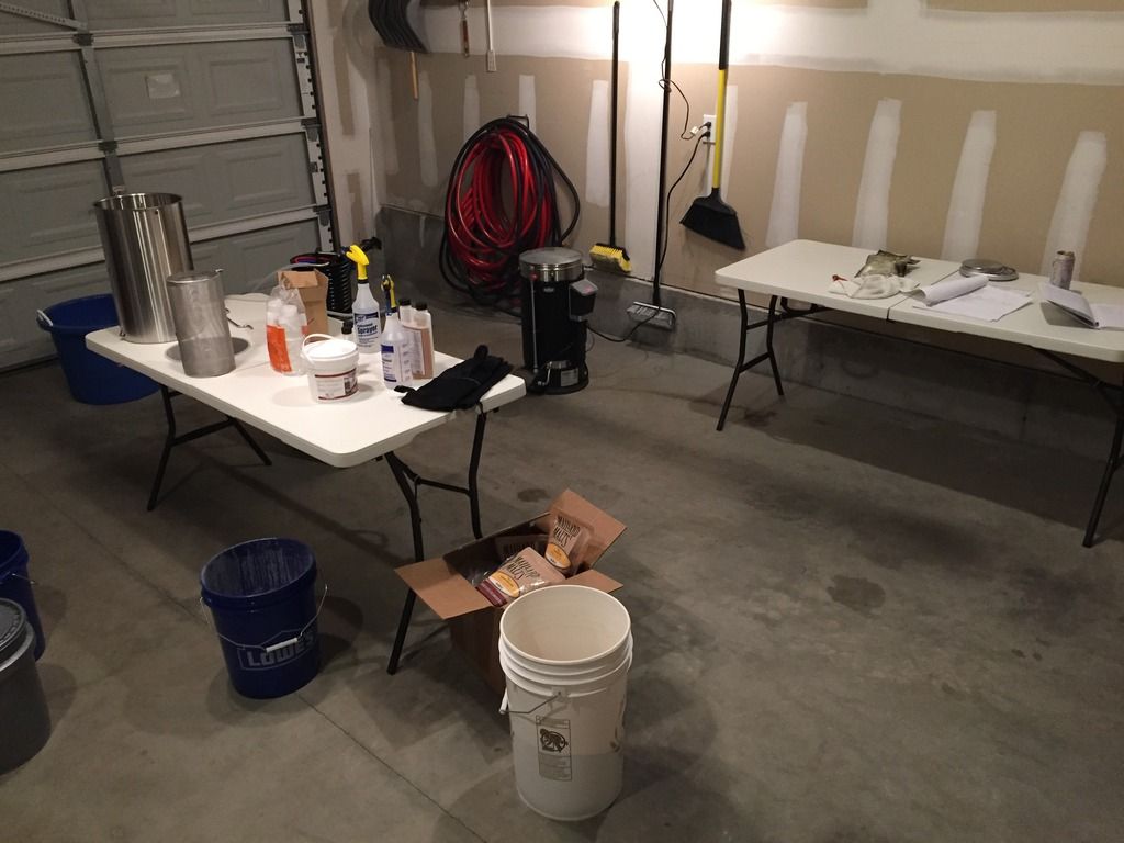

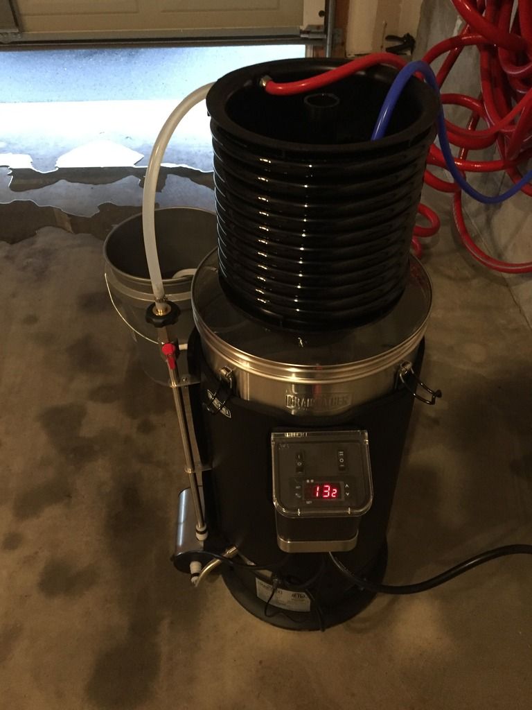

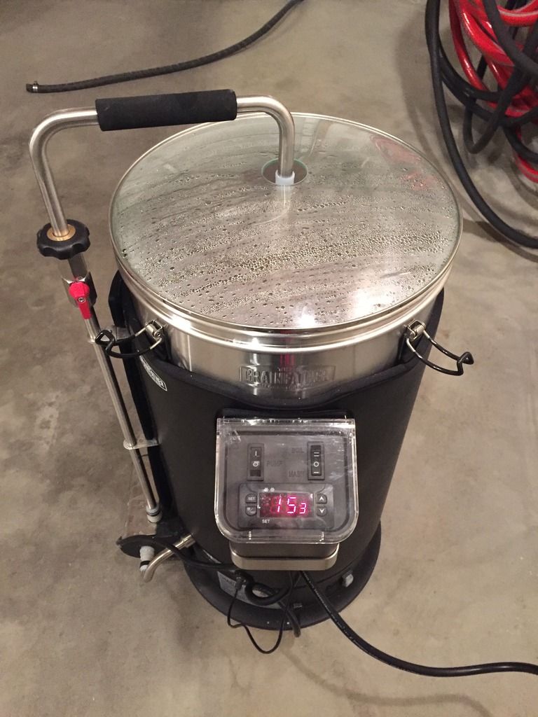

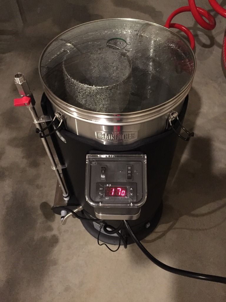

Haven't brewed in 4 years, the old cooler mash tun/propane kettle was an all day event and I don't have that kind of time. Picked up a Grainfather a month ago and already brewed 3 times. You can set the mash temp and walk away for an hour, come back to sparge and boil. Since it's electric I don't have to babysit it like my Blichman propane burner. It's a nice all in one compact system, the included CFC chiller cooled the wort to 65F right into the fermenter.

You can boil as long as you want. Since it's 120V it does take a while to get up to a boil. I turn the switch to boil when I lift the grain basket up to start sparging, by the time I'm done sparging it's usually close. The only thing it doesn't do is heat your sparge water, I have a separate electric kettle for that.
