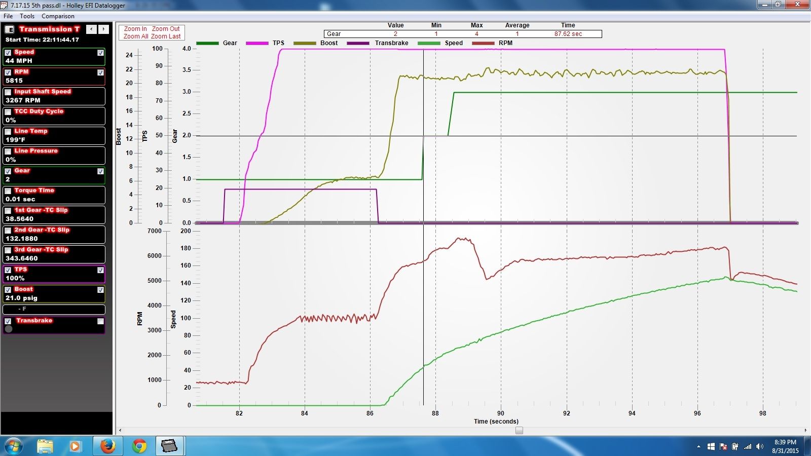

The first, the car does not want to make a 1-2 shift at WOT. It goes right past the commanded shift point, hits the rev limiter, and eventually shifts from 1st to 3rd.
I have tried adjusting the WOT shift RPM and also have tried different Shift Tables. It didn't seem to help. It is difficult to test on the street because of the power on the 1-2. Currently, the car is down, but looking to see whether people think there is something mechanically in the transmission, or electrically in the tune.
The image above is from my latest track outing. The WOT shift was set at 6500 on the 1-2 shift. I eventually pedaled the car and then got back into it in 3rd gear. I have a transducer on the 4L80 and this is labeled "4L80 Pressure". The thing that stands out to me is how the pressure is falling off around 5800 RPMs.

I have also tried lowering the 1-2 WOT RPM to 5800.
This is a screenshot of that pass:
I added the transducer between the passes. The pass at the top was recently in August versus this one directly above that was in July.
Looking to see where we can go with this. I can try to post the Data Logs if needed.

Intermediate clutches. Had the transmission freshened and works as it should.
