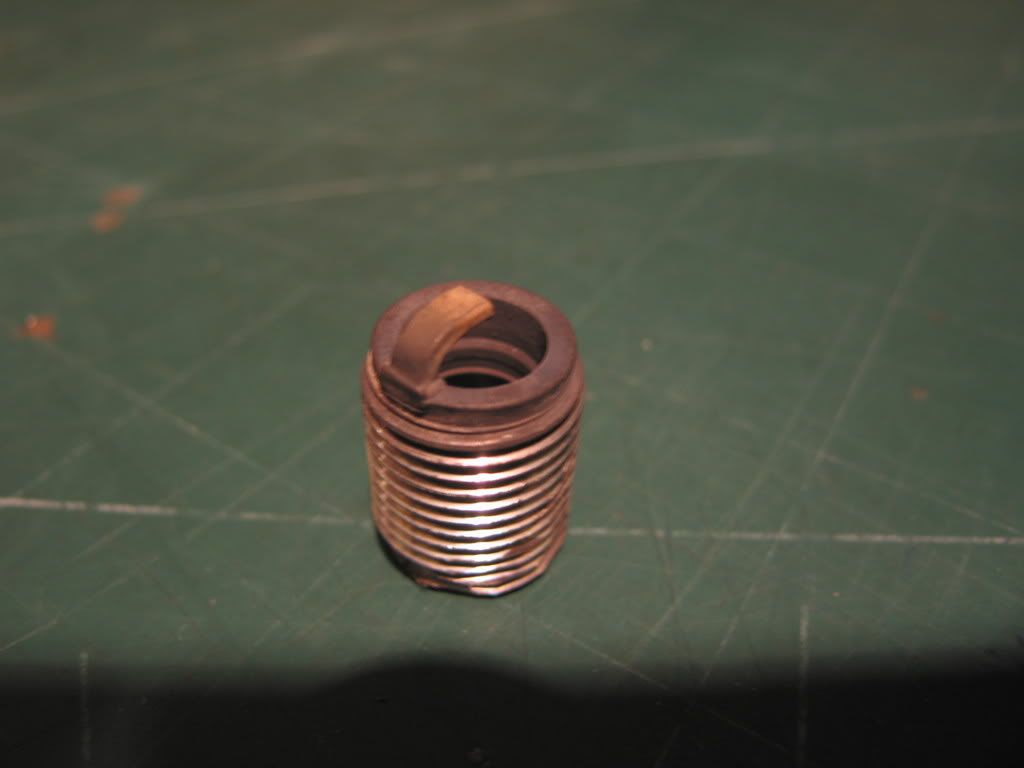

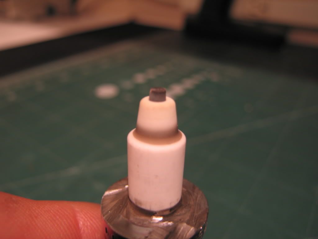

i switched to 5671-9 ngks and emptied out the pump gas and ran 110. pulled four degrees of timing via a digital 6 from my 38 i run when i run n/a. heres a couple pics of a plug. they pretty ,much all look like this one. its not visible in the pics but there is some black specs on this one as well as the others. the tune is fat from the look of the porcelain as well. my question is that since its obviously not lean do i need to just keep taking timing out until the specs and ping goes away? why is it just pinging for the last 100 feet of the track? i watched the f/p guage on a couple runs and it never moved so im not losin pressure. im just kinda stumped and hoping some of you guys can help me out. im trying to get this 50 shot straightened out before i move to the 100 shot.

I'd put a ngk-7 in there. Needs more timing, not less. There is not heat in the plug. Is that one pass? If not it's kind of useless.
Is it popping in the exhaust? I would think it's loading up.

Slimbo, I think you are doing everything right. Something must be happening that is not visible. The -9 is cold but who cares. It runs and it will not cause detonation. The porcelin may look rich only because the plug is very cold. This is why I dont even look at the porcelin.
Did you ever test the retard with a timing light?

yes mike i did test the retard with a light and it is working. the spark bounce may be on the right track, i will lock the dist out and try that. i figured the -9 would stop the detonation but obviously it didnt. mike since your familiar with the nx express tunes i had gone to 9 pds of fuel pressure and the detonation set in at the exact same point but the band on the plug was lighter. so i swapped in that new set of 9's and tried it with 10 psi and got that thick dark band showing a richer condition. that plug was one pass.

if i dont run it on the juice i get no noise. car picks up about 4 mph on the 50 shot so i cant see it being anything else. i used a cut off tool to split the plug. only took a minute. im gonna pick up a couple sets of -8's for this weekend and lock the dist out and give it another shot. my engine builder is pretty good but i also want to check tdc and make sure the adjustable pointer he installed is set correctly.

looks like the strap is a tad hot. the 8's should fix that and she might run perfect!

the 8's are hotter and i had a set of 8's in before those with identical results. thats why we went to the 9 hoping to remedy the situation
