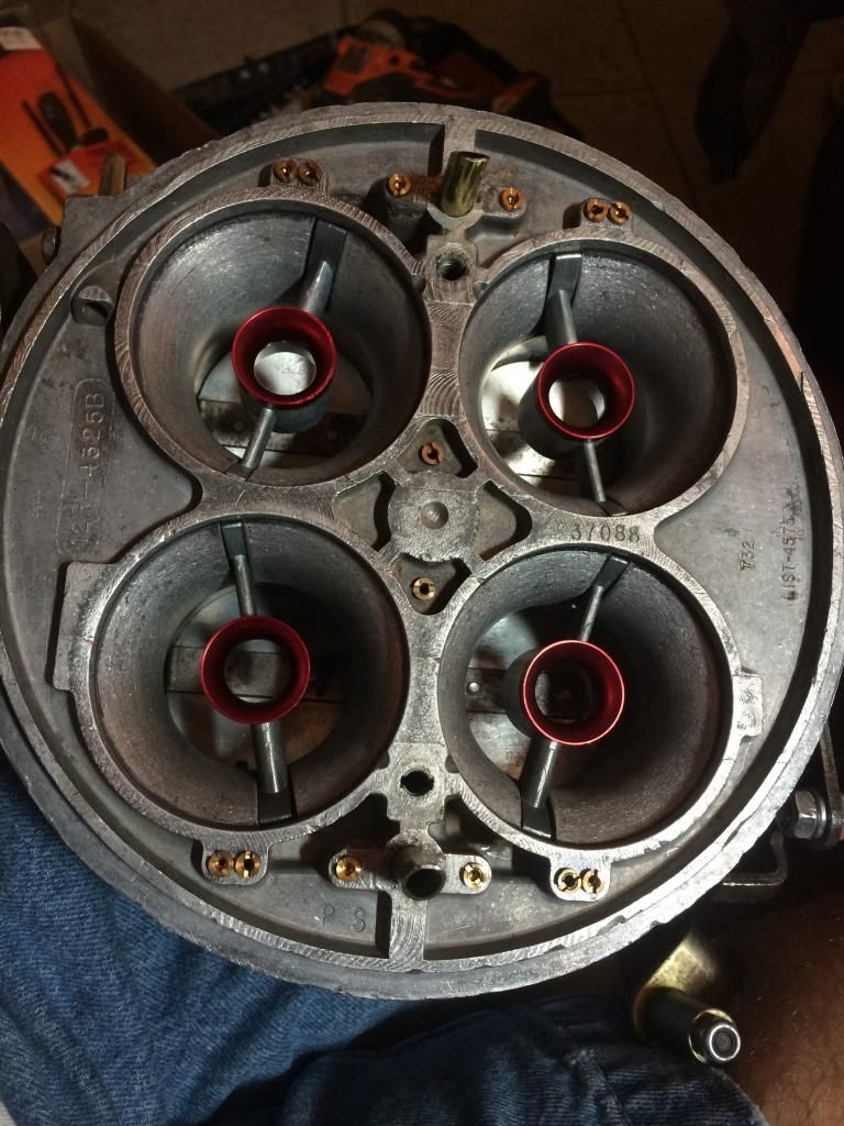

What are those 2 two jets in the center ?
6,642 Posts
Looks like the top was cut off with a hacksaw, the tab that locates the squirters from spinning are milled off as well. Going to need a dowel of some sort to fix that. Wish I knew who did that work. I'll try to post some pics when finished.
440 Posts
Mark,
Ive seen a few around here that look like that. Someone milled that down as you can see the shitty milling marks that are left behind. Looks to be a older Pro Systems unit. Im thinking someone milled it down for hood/scoop clearance. Ive bolted small square blocks down to locate the squirters before. If i remember corrrect I used some 2-56 screws. Good luck with that one.
Wild Addiction
2,299 Posts
looks like it would be easier and cheaper to just get another body no?
510 Posts
That looks like an abomination.. Keep us updated on what other surprises you find!
