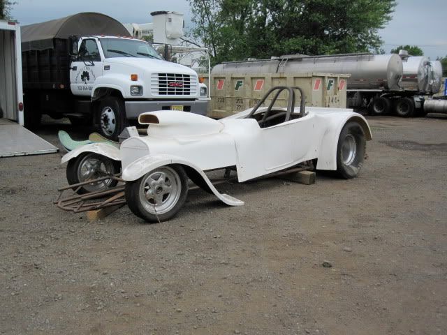

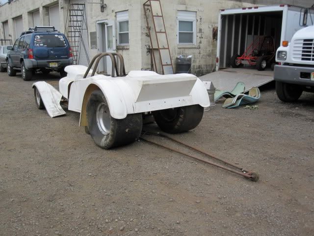

Have a guy who wants to trade me a 27t chassis/body for a motorcycle that I dont really want and is only worth about $4k. The roadster is almost a roller. It doesnt have spindles or any steering parts. The car was never raced, and it was last cert'd in '93. It's sat in a warehouse since then. I dont know if the cert for these cars has changed much over the years, but if I have to add a bar or 2 to meet 10.4, its not a big deal. Basically, I'm just wondering what you guys might value this chassis/body at. Its all 4130, and he also has a seat pan, floors, and a front and mid motor plate. Heres a few pics...
2,289 Posts
You might have scored a good one there. I see it needs the eye bars on the cage, and gussets. I dont have an SFI book here, but might have to do a whole new cage, because of what I mentioned and the angle of the front hoop. I cant see with the body on about diagonals around driver, but might be ok....
What is that thing, 120" with a solid front end ? Make a brace for a step under the running boards, you will want that !
I like those kind of cars. under 2K lbs and easy power, and your hauling ass. If it was me, and I didnt want the bike anyway, Id have a new project, for the fall !

Heres a few more of the bare chassis. I'm kinda thinking just to get it re-certified,make it a full roller and maybe bodywork/paint it. Think I might be able to make a few bucks if I went that route?

Definitely a lot of work, just thinking I might be able to make a few $ by "flipping" it, but it might be more work than its worth...
7,265 Posts
I would guess that its not worth very much. I know someone who recently sold a very similar roadster as a COMPLETE roller, with extra alumastars and other parts- $12k

I agree in todays market I have seen some sweet complete rollers including electronics for 10K some even lower.....I'd have to pass on that deal :cool:

I don't know about this one Dude it's kinda "Iffy". Alot of variables to consider atleast it's C/M! If it was M/S I would pass. If you think it's a fair trade for the bike (Since you really don't want it anyway) & you have been looking to get in a Roadster & realize how much work is left in it to get you where you need to be well then maybe you should consider it. Whatever you do don't do like a Zillion other Dudes ALWAYS end up doing....jumping right in the first deal you see!!!! So many people do that & a couple days after the deal is done it's like..."Damn did I Fuck Up"? or "Shit! I should of waited" Hey we live once! If you like it & it's what you want then go for it! Your the one who is taking it down the Track!!! Either way...Best Of Luck to ya!! :cool:

I think I'm going to pass on the deal. I dont really have any desire to race the thing, just was thinking it might be something I could put a little bit of labor and a couple dollars into, to then sell and make a few bucks. It's looking like it might be too much work for too little money it seems. Thanks for the opinions!
