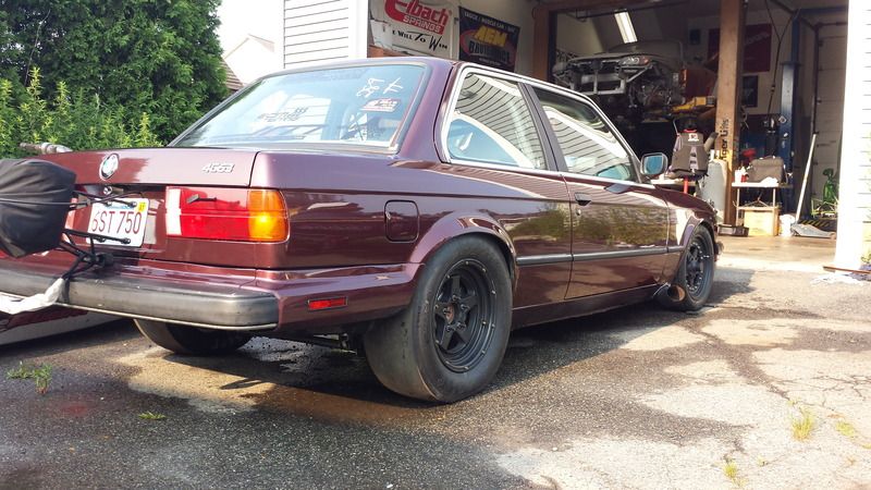

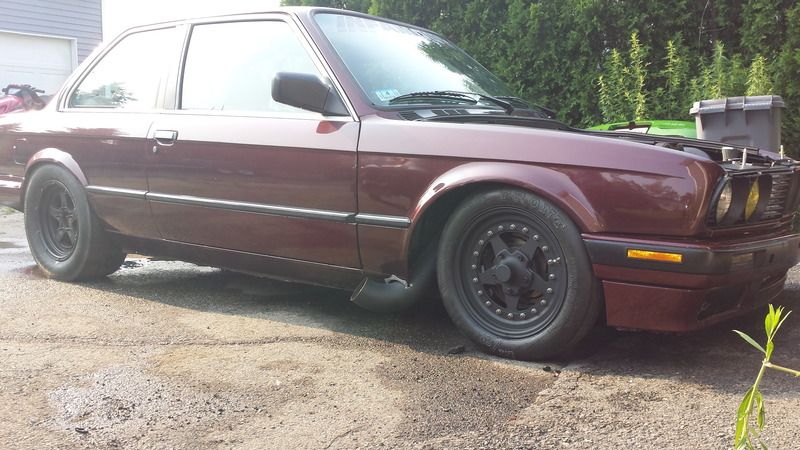

Hi guys I'm very green when it comes to chassis tuning so please bear with me. I currently have a BMW e30 with a solid axle ladder bar setup and strange spindle mount front struts combo. The car currently sits with the nose raked down. As most of you know the strange front struts don't have a lot of travel so I don't have much adjustment to get more front ride height out of the coil over. I would like to raise it up because I only have 2" of trans pan clearance and its a pain in the ass to load the car on the trailer and drive over the smallest bump (god forbid if it ever wheelies it would be a mess) The car currently has 22" front runners and I just purchased a set of 24" fronts in hopes to get more ride height. My question is how bad am I going to throw off my current setup by going to this taller 24" front tire and not changing anything else? What should look over or readjust in effort to keep my 60's in check. Granted I'm not cutting the best 60's (1.33 on 26x8.5) I just don't want to go backwards.

Maybe it's just the angle of that second pic but it really looks like when you put the 24 on there you're gonna hit the front of your fenderwell/bumper because the tire is gonna be 1in taller all the way around from where it is now... Why is the tire so far forward in the wheel opening? Did you move in forward putting the struts in?

I already measured that and it's just going to clear, we did move it forward in effort to increase wheel base.
