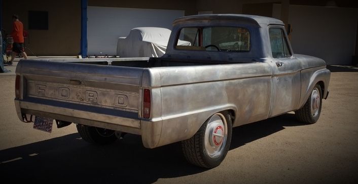

Truck 1 as it sits now. In Testing/Tune Mode with approx 100 miles so far.

Eco 1 pretty complete is 4238 lbs. Still need to add more interior but take away a bunch of wiring. This is with a full tank of fuel. Yes I am running the 6R80 in both Eco 1 & Eco 2
Eco 1 has 255/55R 18's and 3:15 gearing
Eco 2 has taller tire at least for now with 3:54 Gearing in a Dana 60
Eco 2 has ported exhaust Manifolds, Ford GT Turbo's and a no Cat downpipe. Hoping it will make 475+ at the tire.
Eco 2 should be around 3700 lbs. Goal was 4000 lbs or less. Those 2.7's are strong runners!

Still in the middle of trying to get a proper "tune" in it. Getting close but weather has been pretty warm. Still managed to put a total of 580 miles on it so far.
A couple nights ago did a 118 mile trip on local freeways & sticking to speed limits. Mostly 65 mph just to check the MPG. Managed to pull off 29.3 MPG for the trip! Somewhere in middle the Tune started to pull timing so think it could be better. Was quite hot out at over 100 deg at start of trip.
In process of removing wiring and components that are not needed but at same time trying to keep warning lights etc off.
Been messing with a few 0-60 Runs as goal is in the 4's which I think is reasonable for a 4x2 with daily driver tires. Not quite there yet as now low 5's.
