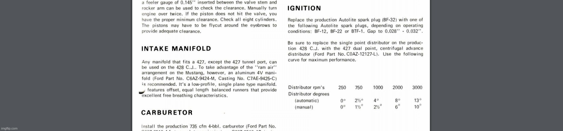

Good stuff ^^ but not it.
Good stuff ^^ this is it.
Oh yeah /\/\ there it is. Thank you Thank you ....
You see why I thought it must have been a misprint and that they mixed crank and distributor RPM? Look at the curve for automatic, 2000 to 3000 is 4000 to 6000 crank RPM and 8 to 13 dist. is 10 degrees crank advance from 4000 to 6000, which just seems nuts to the "all in by 2500" crowd.
Understand that I finally understood it wasn't a misprint about 25-30 years ago when I got into tuning carb restricted circle track engines and realized how much more timing was necessary and a significant advantage when VE is limited.
When you consider how the overall 428 SCJ engine was configured for Super Stock (at that time ~1968) with the small carb (735 CFM) and not so stellar breathing, with the 330 deg .600 lift cam which is going to want to turn high RPM where the VE is falling because of the small carb and meh heads, it makes sense to add that much timing because the cylinder pressure is falling significantly as RPM climbs. It must have worked OK because the Ford house cars (Tasca Ford and I forget who else) were on top of the game in their classes.
Notice in the other sections of the publication about the 427 with Tunnel Port heads and higher compression ratio, same 330 deg .600 lift cam, the recommended curve is not like the the 428 SCJ, the 427 is "all in" at 4000.

The single thing that wakes up the Boss 302 is the advance curve Ford published in the off-road tuning literature, the "Muscle Parts" books. They specified the spring part numbers and fortunately they were the same springs as in '65 and '66 300 HP 390 engines,
Ford Performance Book #2 ( found the book today)
The first tip is: "The first step in going for more revs is to disconnect the limiter"
That 330 600 lift cam was meant for a 427 which is a short stroke big bore engine not a smaller bore bigger stroke like a 428 CJ . My buddy Barrie Poole raced super stock then and won the Winter Nats 2 years in a row 70 and 71 in a 69 Mustang coupe . He learned short shifting picked the car up over a tenth .He was shifting at 5800 rpm while the rest were shifting much higher . The Stark Hicky driver asked him to drive his car and he went a tenth and a half quicker than it had ever gone by short shifting .
30,515 Posts
Thank you. That's it, the curve for the Boss 302. Thanks again.
When I look at the detail in that instruction, 1 crank degree per 1000 RPM from 2000 to 8000, I figure it is significant that Ford specified each 1000 RPM from 2000 to 8000. But what would they know? The experts in the magazines (and the internet) say, "all in before 2500."
