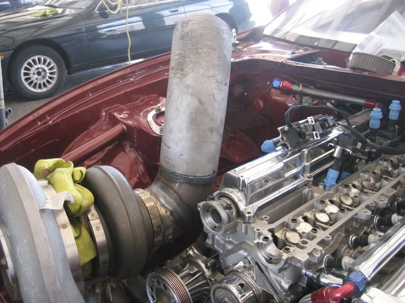

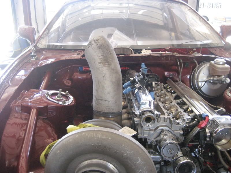

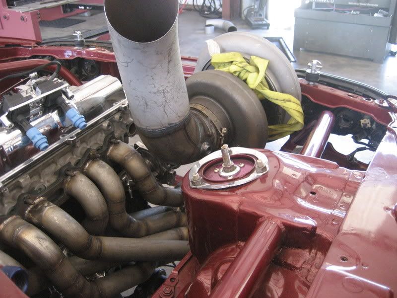

We are running a Toyota Supra but I thought I would ask some of the experts in here. Does it matter where we mount the DP? I'm thinking about shooting it straight up and cut a hole in the hood. I've talked to different and getting different answers. Would it effect the top speed? I know dumping to the side would be the best bet here. Since it's a freaking 5 inches exhuast, we don't have any spaces. Please voice your opinions. Thank you in advance.

After looking at some options. I don't think it's smart for us to dump it through the hood... So we have to go back to plan A... behind the front wheel. This is how we had it before
BTW, This is Bullseye S595 turbo that we are running. Here are some additional pictures of the build. Thank you folks!
