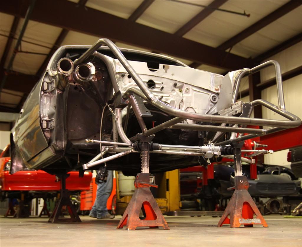

We installed a new Pinto-style rack and tie rods to replace those items damaged in his accident.

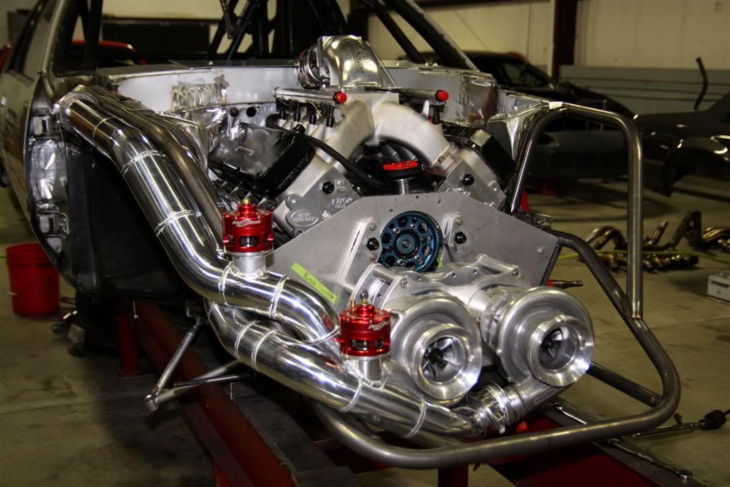

A new inlet tube and mounting plate was fashioned out of aluminum, with a V-band connection.
ProCharger blowoff valves were installed into Don’s new charge pipes. Check out how the tubing follows the contours of the new framerails!

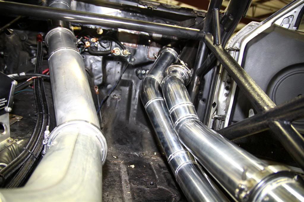

Inside the car, we ran dual 3.5-inch tubing all the way to the intercooler.
Gerry spent quite a bit of time reworking the intercooler itself, which had to be modified with new dual inlets and a single large 5” outlet.
Dennis welded up the mammoth intercooler discharge tubing.
Another view of the interior.

The bars that are sitting on the jackstands(in this pic).......where do they attach to?

is that a schoneck front bumper???? and why not do dual 3.5 merge to like 4 or 5" instead of 2 intake pipe to cooler???

Sweet. Just curious why there isn't a Y on the superchargers and one pipe to the IC? I don't know that much about twin setups but that's that way you normally see turbos plumbed.
Its a our 10" outlaw Lx cover
