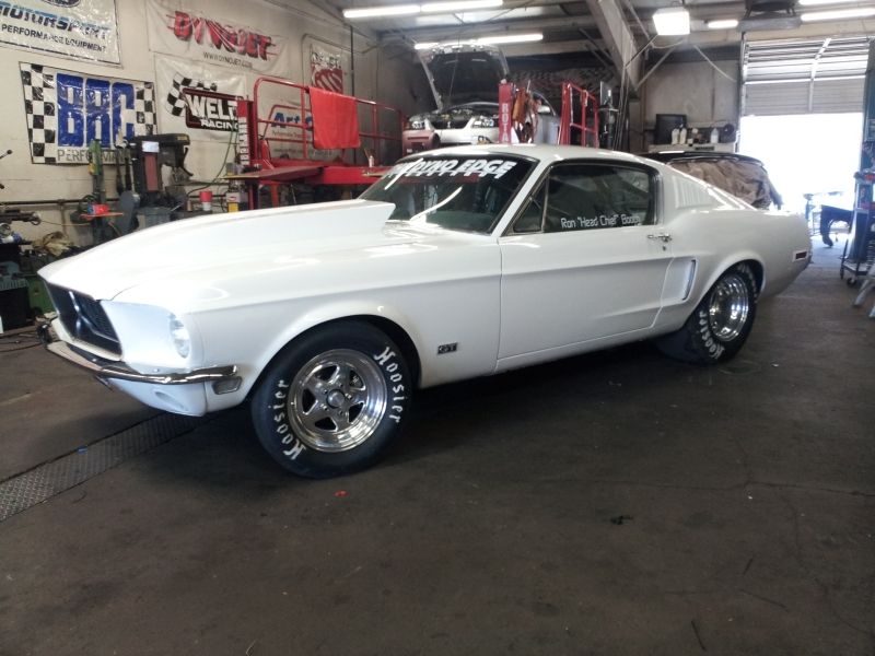

My father in law has a 68' gt mustang fast back 4 link car that has a wicked deceleration side to side wobble, let me know your thoughts on where to start figuring out what the problem could be, don't need the ol man getting hurt,, ill answer all the questions you have and get more info if needed. Here is the car... Thanks for any and all comments and help.. I'm thinking its something in the 4 link but I'm not versed as much as I should be with this set up, does not have arb... Thanks again...-SL
