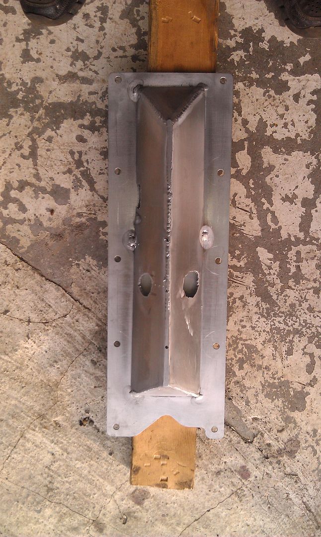

it doesnt have to be elaborate, it just has to be built in a way that oil cannot directly get to it...
the bigger problem is that the LS motor has a splash window at the front of the valley....some have one at the front and the rear..
the only thing you can do is to pull from a place where there is no splash..somewhere in the middle of it
I ended up making a simple baffle
Front of the motor being the bottom side of the picture
and the space where it draws in from is in the middle of the valley....
my actual Fitting in the valley cover is up at the front of the motor and in front of the Super Victor Intake I am using.
