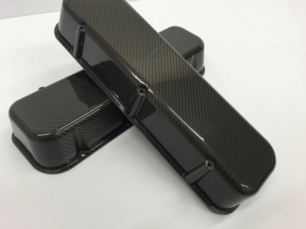

BBC valve cover mold is now done and they are available for sale at $800/pair. These are pure carbon fiber, even the flange. Not only are they beautiful, but also very lightweight at about half the weight of the exact same style aluminum covers.
We also make SBC, SBF, LS, Big Chief, Suzuki Motorcycle and BAE Hemi covers at this time.

Are they drool resistant? What is the best way to add fittings, carbide grit hole saw.?
Best thing to use for large holes is a bi-metal hole saw. For smaller holes, 1" and less, I like to drill a pilot hole and then use a stepped unibit.
Did you do a similar Alu mould for the standard valve covers?
No, the mold for the regular BBC is our typical fiberglass mold.
