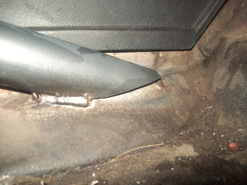

Putting in a new cage for a customer, this is what WAS in it, and yes it had a up to date inspection sticker from our local 1/8 mile track!
WOW, and yes ofcoarse it was black iron pipe!!!

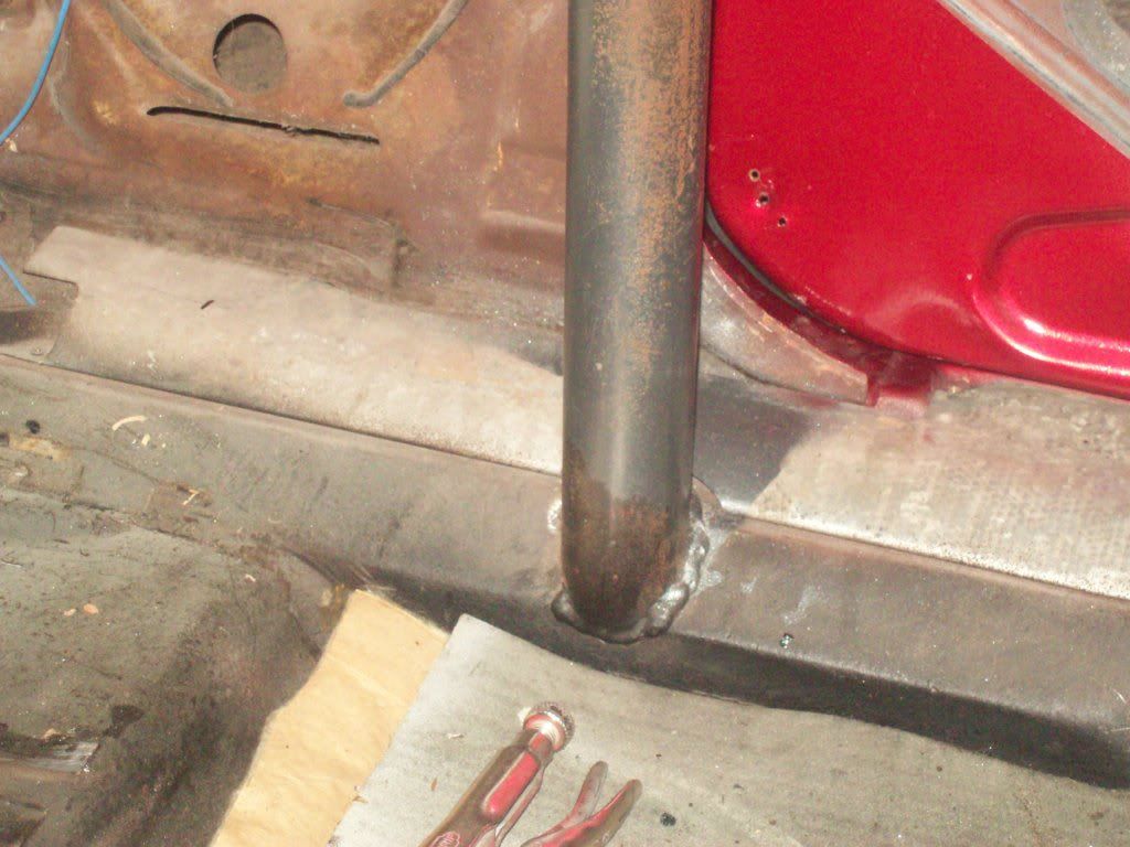

NAH, who needs mouting plates????

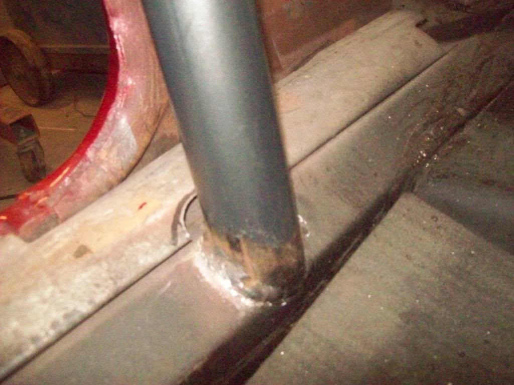

door bar mounting!!! WTF?? and yes both sides matched

the 3rd pic is very common,i even found that done on a cage built by a reputable shop.
REALLY??? Wow id be pissed if somebody installed my cage like that!!
I plate there, run a sill plate bar, then the door bar and A pillar bar all ty in together there...

You know over the years there has been some CRAZY ASS SHIT! out there getting a Cert.Sticker....Guess some of the Techs care more about the $$$$ they get for checking it than the safety of us! FUCK-THAT-SHIT!! :cool: You have got to LOVE pic # 3!!!!!! Ray Charles (May he R.I.P.) did that one.

And WTF is with that 3rd pic? What's it mean when you half-ass a half-ass job? Quarter-ass?
