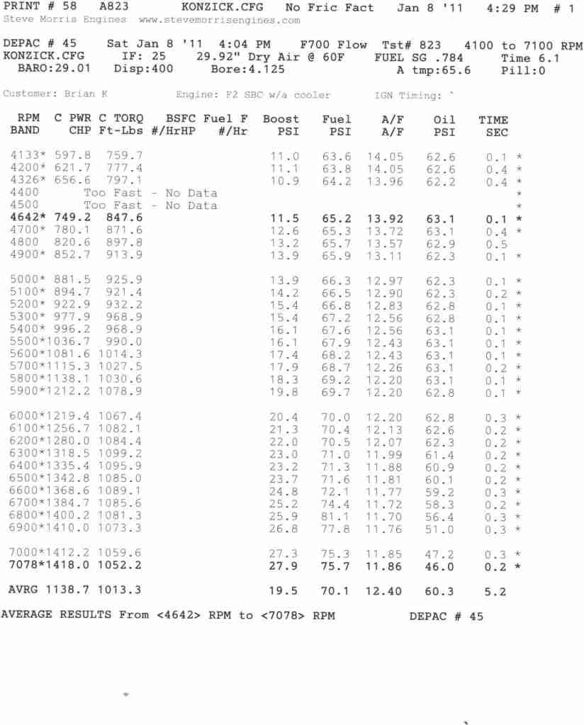

I am maxed out on my 400 ci AFR 227 F2 engine . My goal is to get my 3730 third gen Trans am into the sevens. I can easily get my weight down to 3500 but that would be the lowest I could get the weight . I am going to try my best this year to see what I can get the car to do with my current set up but I think i will fall just short of the power needed to reach my goal . I want to start accumulating parts to convert over to the All Pro 245 RR head for next year 2012. I cant seem to find a whole lot of information on what it takes to put these heads on an engine. As far as I can tell I will need a new shaft rocker .550 offset system , a new intake , .180 offset intake lifters . I am wanting to try to keep my existing pistons . I know that the valve is I believe a 2.18 valve and my engine builder thinks that with the cam profile that I am using that I may be able to make the pistons work but he is not sure and is going to check on that . I cannot fly cut my pistons as they are hard anodized . I am also wondering if my spread port headers off my AFR 227s will work on this head ? If anybody has converted over to the All Pros 245 RR and you can shed some light on what is possible and what is needed I would appreciate the info. Below is the way the combo sits now . This is a general idea of what my output will be on a liveable tune just have to fix my regulator to clear up the lean spots as it was not boost refrencing properly . If I lean on the engine I may be able to get a little more power out of the engine but the cylinder heads would probably free up some decent power as I am spinning my blower at 55,000 rpm and can easily go to 65,000 . Any feedback appreciated. Thanks

Why did you all stop the dyno pull at 7K? I'm only seeing 28 psi from an F2 should have more left. Under load on the track it will have more boost too. Even if it doesn't make anymore power you still need to shift the motor using the most HP average. I shift my motor 8200....Unless your class restricted on head why not just use an 18 degree SBC head.

We only made one pull on the engine to 7000 because we ran out of time. We were doing small pulls trying to fix the low rpm fuel curve . We suspect the regulator is bad because it would not boost reference properly. I suspect at the track that I will have to shift at least at 7500 . I am not class limited just a for fun racer . My goal is 7.99 with the car and I feel that I will be just a bit short on power and I dont want to have to change pistons and headers so I figure this head is the best bet for my goal. I am hoping that if I can sell the top half of my engine that it will help offset some of the cost . If I cant fit these heads with these pistons then I may have to rethink the whole thing.
