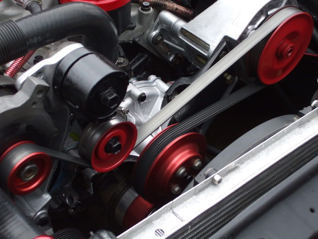

Ok, me and the boy stuck a 89 351W in his 89GT stang, fkr has always run hot, bought new aluminum rad, still runs hot, after reading up on a few builds I was wondering if the W/P we put on his is the wrong rotation for his timing cover.
Had a helluva time finding a W/P that worked with his serpentine set-up if I remember correctly.
Heres a pic
6,266 Posts
I just bought a standard rotation water pump,as Iam getting rid of the power steering,and its is identical in every way to the one in the pic. Going by that and not a part number,you need a reverse rotation water pump. I may have one for sale here soon,its all smoothed out and powdercoated gloss black. But to check first do you have the part number off that pump?
1,381 Posts
Heres a pic

how long has this motor been together, are the HG's positioned with the water ports open at the back...
u need a reverse rotation pump if that aint one... i have a brandnew frpp reverse rotation pump... ordered the wrong one... PM me if u need it.
13,485 Posts
since the basic appearance of a flat /serpentine belt is installed.... the pump should rotate reverse of the crank...
the front cover should also be specific to a reverse rotation pump, because the inner port inside the cover is different....even though all of the bolt locations are the same as a "same as crankshaft rotation" pump.
as said, one or both of the head gaskets could be on backwards...

Iam still shooting at the wrong water pump.
Come on, give the water pump a break. Even if it is the wrong one I don't know if it deserves to be shot at...;)
5,084 Posts
I have to also wonder if you have the correct pump. A water pump from a stock 5.0 mustang is what you want with that configuration. On my 418, I had the same setup you do, with a generic parts store pump, a MK8 fan and DCC controller, and an aluminum radiator.
Even on the hottest days of summer, it never broke 200.
6,266 Posts
Only reason Iam saying the water pump is I just bought a Standard rotation pump from autozone and it looks in every way,even the stamped logo on the front there,the same. You need a reverse rotation for the serpentine setup. I could be completely wrong but thats why i asked if you could throw a part number up.

the contour and shape of the internal fins of impeller are different....
the passageways of front cover and the port is different.
the bolt patterns are the same and even the gaskets are similar, so it is easy to get the wrong one.
in all cases,...you may need more fan or airflow.
drag cars run well with a totally seperate water pump that does not operate off of the serpentine belt.
this also allows you to circulate water in staging lanes to cool down.
it also allows you to pre heat the water on cold days by running engine, but not circulating water.

Jus by looking at your pic ,Id suggest a higher cfm fan like the black magic fan or one that cover more of the radiator surface...I had a mild built 302 (in a fox mustang) that I ran with electric fan from auto zone it cooled just fine. I installed a mild built 351w in the same ride it would run alot hotter until I upgraded the fan.. What temp thermostate are you running? To help out try a bottle of water wet from redline..
160* stat in it now, already use water wetter, it only helped marginally.
Agreed more fan or better air control would probably help, but Ive seen less fan on way faster motors that don't run as hot as this one does, so that has me leaning towards the wrong water pump.
