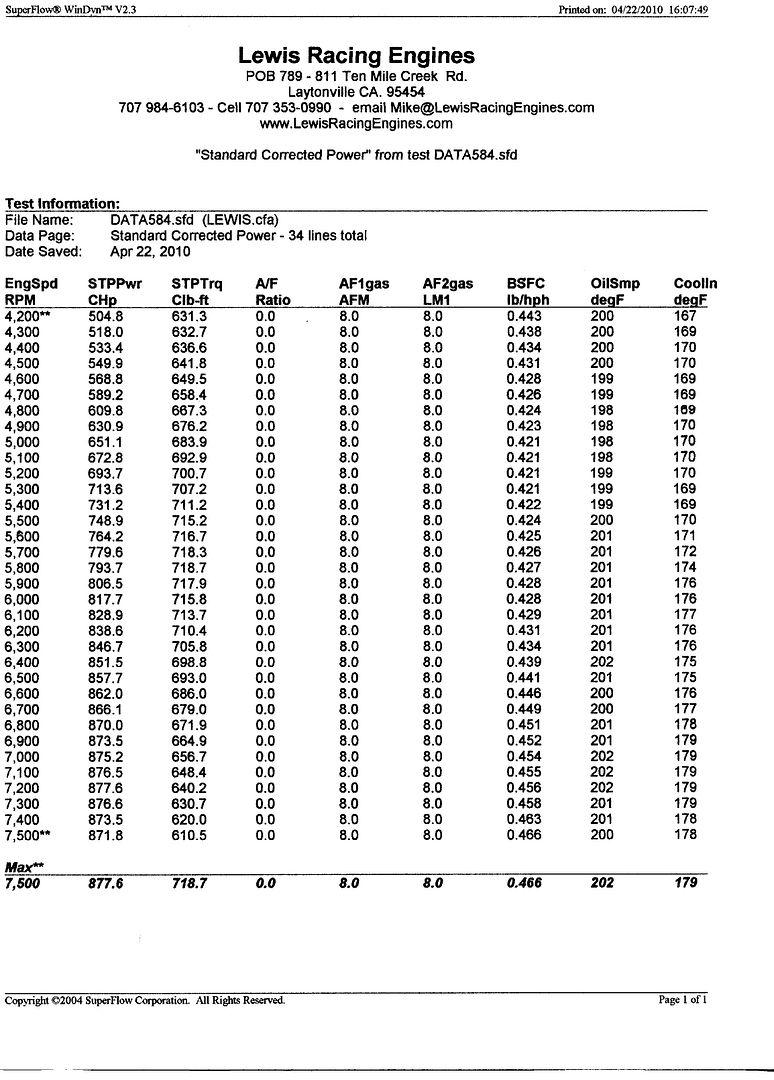

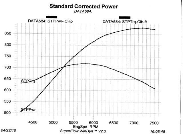

Mike Lewis ran my 555 today with 540 Hotrod's borrowed cam.
788/714 268/272 @ .05. I have a bigger cam to put in it but wanted to see where it would be if I needed to back down a little. The cam change will be next week. Thanks Jim, for the parts and support. Mike has been working hard and here are the results so far.

Do you have plans to dyno the bigger cam and Profiler hardware ?
Is the bigger cam the same one you used during the initial dyno session with the RFD heads ?

Hi Jim I believe there will be 2 cams tested the exhaust ports flowed differently. the split on the first cam is bigger, so there is a different cam for the profiler. But I think Mike will run them both.

Thanks for the info. Still, even with the smaller cam, that 555 is one stout piece !
