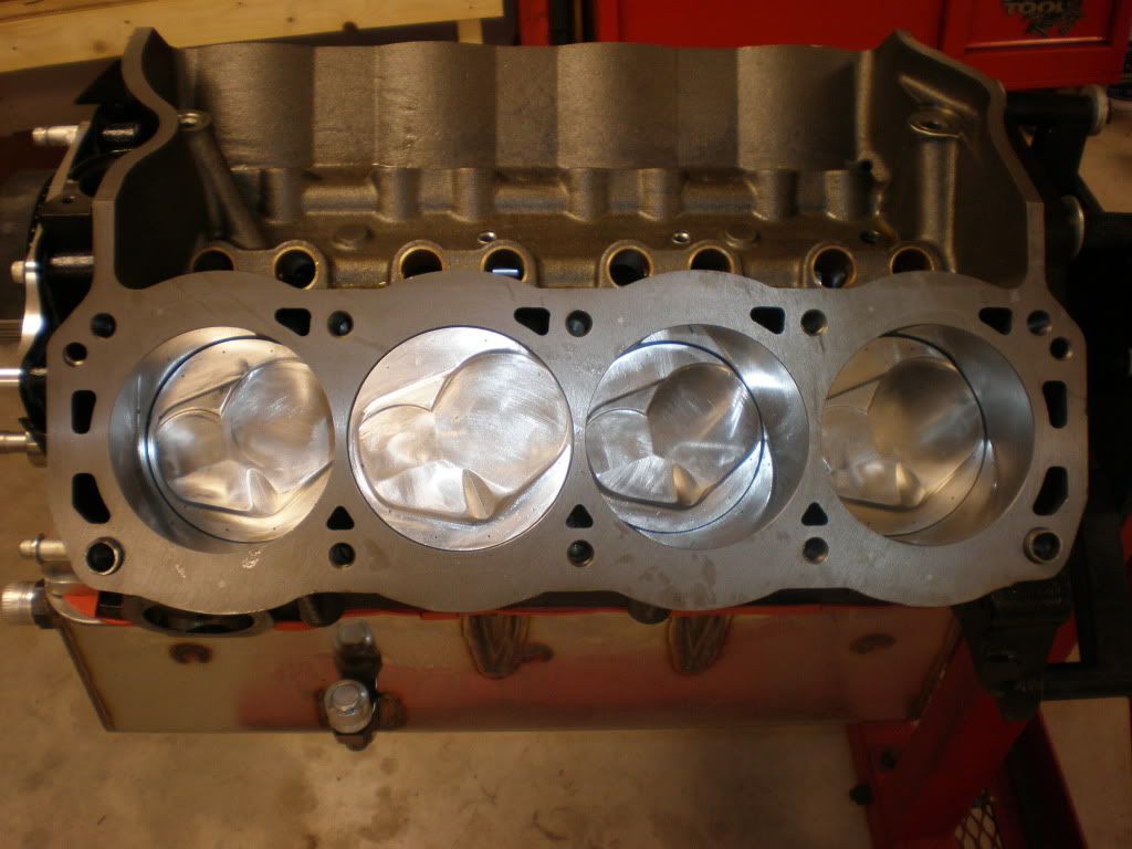

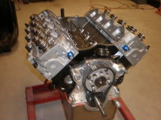

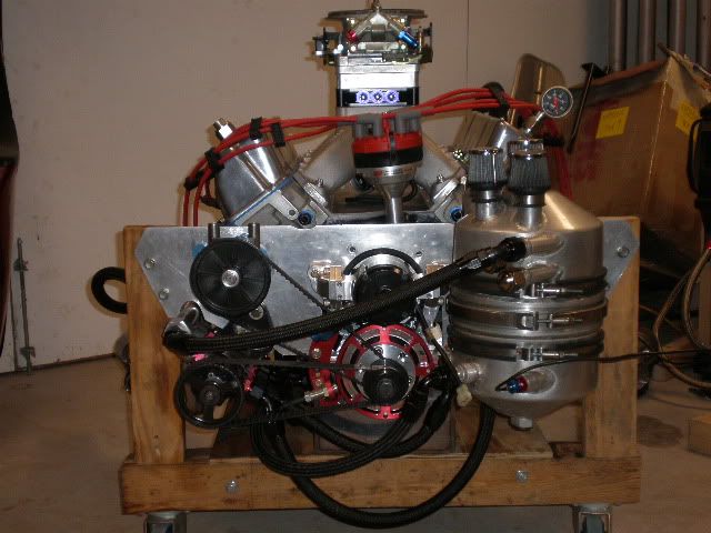

Here is a list of parts and some pictures.
Dart Iron Eagle block 4.00 X 4.155
Lunati Pro Series crank
GRP Billit Aluminum rods
Ross custom pistons 14 to 1
Hellfire rings .043, .043, 3mm
55mm Billit Roller cam 270 in, 295 ex, .850+ in lift, .800+ ex lift, 114 lsa (the cam was designed for nitrous only)
Jesel tie-bar roller lifters, bronze lifter bushings
1/2 inch .160 wall Manton pushrods
Jesel shaft rockers
Ford Motorsport A-3 canted valve heads, 380 intake, 260 exhaust
Titanium intake and exhaust valves
PAC triple springs, titanium retainers, Manton 10* lash locks
Edelbrock 2863 Victor Glidden intake, (custom ported)
Pro Systems 1080 carb
5 stage dry sump pump (3 gallon tank)
Star Machine vacuum pump +

Why run the Vac pump and the Dry sump pump? What kind of #s on the break in pulls?
The dry sump pump only pulled about 5-7" of vacuum. With both of the pumps running I have the regulator on the star vacuum pump set at 15". It holds good through out the entire pull. I know for sure it won't get close to 900hp. It made 785 hp at 7800 rpm. The power was still climbing pretty good and I think there is more left. The cam was designed to make peak hp at 8500 rpms. If I can get 800 hp I will be thoughly pleased with this project.
