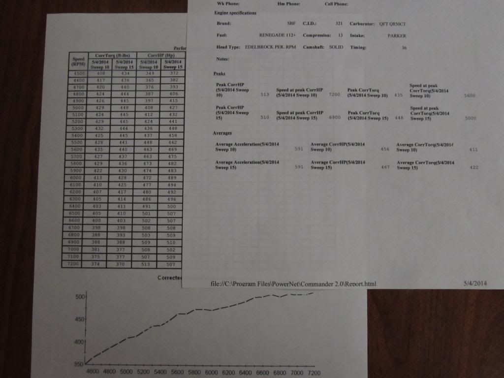

321 Edelbrock Performer Head and Parker Funnel Webb. This one had 13.5 compression but Flat tappet cam. 513 Hp.
I think we had a good day on the dyno today.
I am happy with the results and the customer is too
Engine last year was 467 on gas and 481 on methanol.
We picked up 45 hp peak and 40hp average(ON GAS) over the way the engine was when we ran it with the stock block. We picked up 38 ft. lbs torque average.
On the dyno sheet below sweep 10 is GASOLINE
Sweep 15 is METHANOL.
