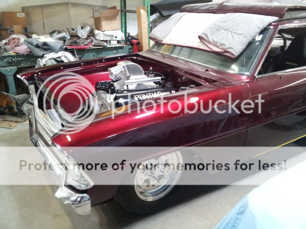

my 67 chevy II is getting closer to being done...i need to decide on tires for the track...it has 315 drag radials on it with a 12" rim....i can fit 16" section and 32 tall no problem....what will hook better and 315 or maybe a 29.5 x 10.5 w tire ?? or what else....i do not run a class at all....just a fast street car that i hope will run in the sevens !!
car specs
2900 lbs with driver
509 bbc F2 reverse E85 , alum block Kieth Black
1400-1500 hp and alot of torque :cool:
4 link rear and struts up front
t400 trans with 4.56 gear !! bad i know....advice ?????
47% on front and 53% on rear
any advice would be helpful....i know i will have a hard time hooking...would love to run a good number on a 315 or a 10.5 x 29.5 but i may not be able to ?? and if a 29x10.5 do i use a W tire or a S tire ???
thanks in advance !!!
320 Posts
I'd say a 29.5W or the 315 but I don't see the 4.56 gear working with either. I've got a car in the shop right now with about the same combo and I'm leaning towards a 3.40-3.60 gear that trans 1st gear and that F2 is a monster with a Big Block.
