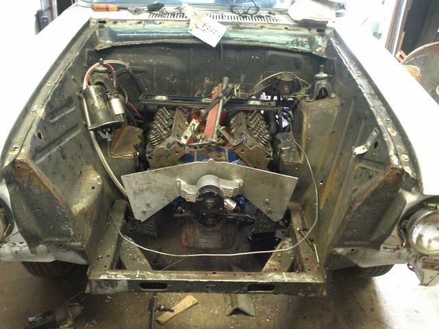

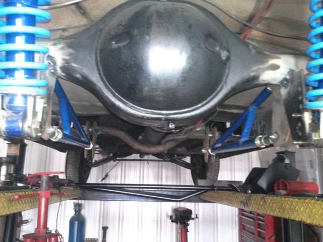

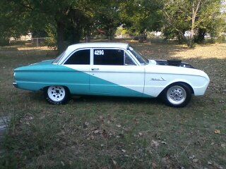

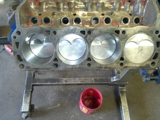

i have ran this car for a couple years, first motor i ran was a 306 ci straight 6, it ran low 13s in the 1/4 and 8.00 in the 1/8, then i ran a stock short block 302 with some RHS heads a vic jr and bullet hydraulic roller at 11.50s--11.60s and 7.20s in 1/8, all with no roll bar, so over the winter we put ladder bar and rear coil overs in, a roll bar, and i had the c4 redone and built a 393 ci motor with eagle h beam rods, ross flat top pistons, a bullet hydraulic roller and ported super vic, it is not a big dollar build, it was built a a small budget , i bracket race it so a max effort build was not needed
video of the 302
http://vid22.photobucket.com/albums/b315/john8189/07271318021_zps0e7ef0cc.mp4
test fitting the 351w , before any fab work started or paint

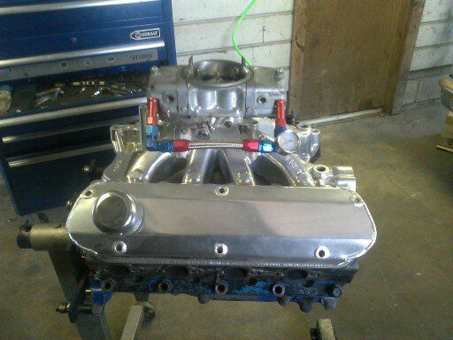

we put a cage in it to already ,here is a pic of the 300 straight 6

that intake is 1 piece with the exhaust all on the same flange, g-pa built that for his 63 back in the early 1980s, i just realized i hit the 3 and not the 2 , my car is a 1962 not a 63, the 300 sixthy footed just as good as the 302 does but ran out of breathe on top end cause of the stock head

old post but i never answered it,i used early model rods which has the .912 pin ,same as a sbf and the 300 motors have the same ch as a 351w piston, so i used dome piston in the 300 from a 351w, ported head with 2.02-1.60 valves, screw in studs , used BBF roller rockers and a comp soil lifter cam .580 lift dont know the dur
