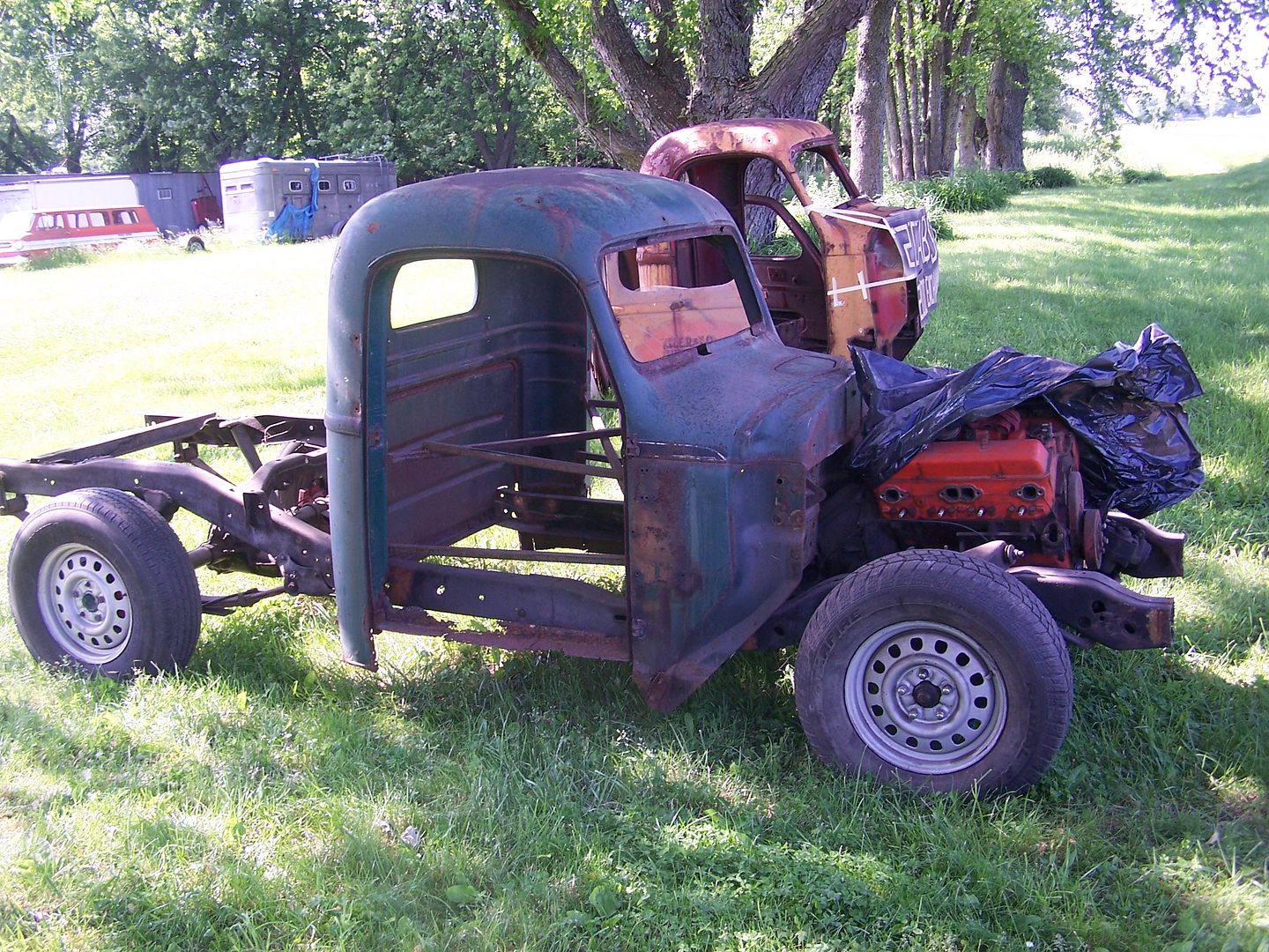

So i was at work friday and had mentioned i was looking for a old pick up to do a street rod rat rod deal. One of the guys told me he saw 2 truck cabs sitting out by this house with a for sale sign on them. So the wife and i decide to take a ride out to see if we can find them. Well we did find them ... i was thinking whats this guy gonna want for these things, everyone seems to think they have gold. The guy who had them was pretty cool and had pretty some sweet projects that he was working on. Well i ended up getting both cabs and other related parts and a sbc 350 and th350 trans for what i thought was a fair price. Actually what i paid for all of it was what i could flip the motor and trans for ...
The only thing i did'nt get was the frame, it was a s10 frame with no title so i am up in the air as far what direction i am going to go with that. Maybe a donor s10 to use the floor pans and seats and pedals and other related shit. Or just go with a street rod frame.... Here's what we ended up with ....
I looked up the name on the doors and it appears that truck was part of The Milwaukee Electric Railway and Light Co... that one is going into storage. i can't tell what name is on the doors of the green one..someone put stickers over what was faded out....hav'nt tried to peel off the stickers yet...
