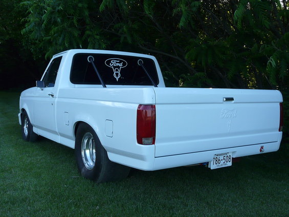

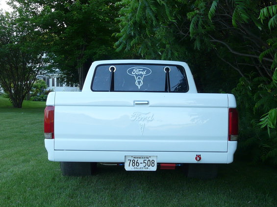

I know this isn't the main topic at hand right now, but this is how we ran the bars thru my back window.....
Figure out where the bars would go thru the Lexan on at and had it fitted before the bars were welded in. Made the holes a little larger than they need to be and put the grommets on. Slid the window as far as it could go away from where we were Tig'n, and welded away. Then, put the Lexan back into the molding and screwed the grommets to the window to cover the holes up on the window. I don't think it turned out too bad.
